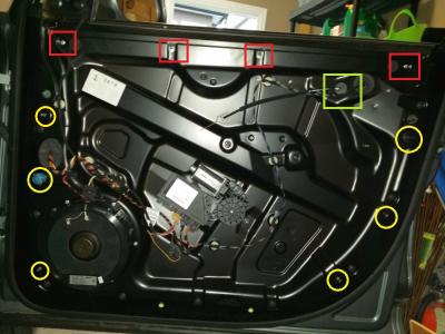

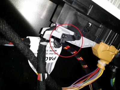

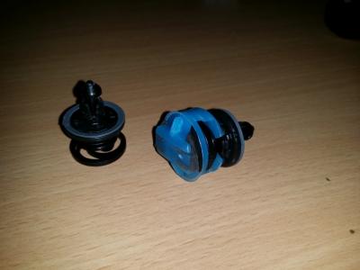

I've proceeded with removing the trim panel. Hopefully recording what I have done can help others. But I still need to know whether or not I have to drill out 4 rivets at the top of the inner metal panel that holds everything, eg. regulator and speaker, etc.. (looks like I will have to remove the rivets). Pull off the inner panel. It has six retaining clips, what Porsche calls "fixing clips". The locations are marked on the picture. Knowing the locations would help you pull of the panel with minimal damage. One of the six retaining clip base broke off and can't be used again. Two others sort of cracked but can still be used. The red boxes are rivets. The green box locates the bowden cable where it enters into the other side of the inside metal panel. The six yellow circles are where the retaining clips are. Backside of the inner panel. The 3 yellow circles show the retaining clips that were undamaged when I pulled off the panel. The 2 orange circles are where the retaining clips stayed on the metal panel. The one on left shows the base is a bit damaged but still can be used I think. The 1 red circle shows where a retaining clip base broke off, like can't be reused. The 2 green boxes shows plastic blue alignment pins. They fit into two holes on the metal inside panel... so to pull the trim panel off, one has to pull it out from the bottom first (so the alignment pins are out of their holes), then pull the panel up. Across on the top of the inner panel is a strip that runs practically the whole length of the panel. It hooks into a grove that runs the width of the door. There are 3 clips that help retain the inner panel at the top. The yellow circle shows the marks left on the strip by one of the clips. The clips are small and not very strong... so to pull the inner panel off, like described above, pull the bottom out first then just jiggle and lift upwards. The following picture show one of three small clips in a groove at the top of the door. I don't know if it was necessary, but I lowered the window all the way first before pulling the inner panel off. Disconnect the speaker connector (tweeter I think). Then disconnect the bigger multi connector (controls the window and another speaker and power locks I think). The following pictures shows a lever that needs to be "moved" that helps pull out the connector. I will continue with the next post (due to total picture size upload restrictions).

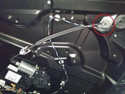

2005 Cayenne S front passenger bowden cable broke so passenger cannot open door from the inside using the inner door release lever... have to open door from the outside. Part number for bowden cable is 95553102400 I think. Followed "Door Panel Removal" instructions. Inner panel almost all off, just have to remove the top part of the panel thats still "stuck" to the door... have to figure out how to "pop" it off without breaking anything. Stuck my hand behind panel and felt bowden cable is broken. The "door panel removal" instructions were helpful. Is there instructions to replace the bowden cable? The cable runs into the door panel to the other side of the door. Do I have to remove the lock actuator? I have no idea right now. Thanks in advance.

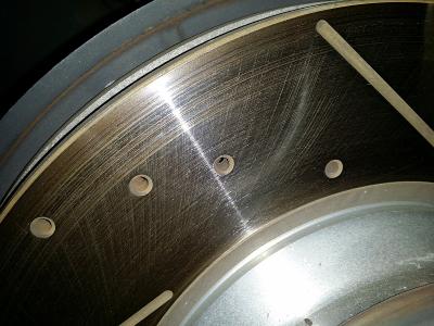

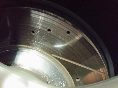

The picture above is a brand new rotor prior to any use, which also means no bedding. Here are pictures of the rotor after three beddings ( each maybe a month or two apart) and about 6 months of light everyday city use. Driver side rotor: Passenger side rotor: Obviously there is a problem with what I would call uneven contact/wear. I do not know how to get rid of it, ie. make it wear evenly or is it a defect of the pad or rotor itself. Look forward to replys from the expert Forum members. Thank you. The only thing I can think of is I went too easy when bedding and should really "go at it".

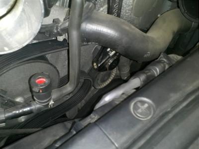

Update: Loosened belt, then checked pulleys, power steering pump and water pump (couldn't reach far enough to check AC compressor and generator). Result: Water pump and power steering pump pulleys: no play and rotates OK (far from a thorough inspection but seems OK). Left and right pulleys: rotates OK, left one has no lateral play, right one has minute play. Tensioner pulley: Rotates TOO freely, eg. spin it with my fingers and it would spin for about 10 seconds before stopping, this to me means there is no lube inside where the bearings are to allow it to "free wheel" for such a long time. Of course, since I don't know what a new one is like, I am just speculating. There is about a 1/2 a millimeter of lateral play... a little more that what "feels" right. My conclusion: A bearing in good condition should have enough lubricant in it so that a pulley won't be able to spin so freely. This means the tensioner pulley needs to be replaced. ECS Tuning has it for about $37.xx plus shipping. I will report back when I install it and hopefully, this was the cause of the noise. As for the engine starting screech... another post: "2004 S starter noise" has good info. 12" adjustable wrench to loosen the tensioner, just long enough for leverage. Home Depot 30mm box wrench was about $12, longer for leverage.
