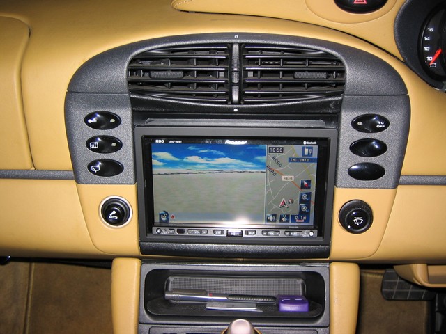

I had the AVIC-HD1BT fitted to my 98 996. (Fitting was included in the price, so I though I would take advantage). The reason I went for the Pioneer is that it was the only one which incorporated SatNav, DVD Video, Bluetooth phone, iPod connection (extra cost), UK Speed camera database (extra), voice activation and HDD music library (hardly used with iPod). We don't have satellite radio in the UK, so that wasn't an issue. Overall I am delighted with it.
Being an early 996, I ended up with a gap at the top of the AVIC. I cut up and glued the old a/c surround to fill the gap, and it worked out really well.

Alistair, I had it fitted by Road Radio Ltd (www.audio66.co.uk) in Crawley. It was £1700 plus £45 for the iPod adapter, and £39 for the TeleAtlas camera database. The iPod is in the centre console compartment. They did charge me an extra £35 for fitting, as it took about 5 hours. I can't complain, as they did a nice job.
The SatNav is very good and it is a huge advantage to have TMC. Like all the satnav systems I have used the voice instructions aren't absolutely perfect, so I find I need to glance at the screen at junctions. The camera database is a bit out of date (it still beeps at the temporary cameras on the M40 which were removed 6 months ago) but they tell me a revised version will be out soon. It certainly isn't as good as the Origin b2 I had before, but it isn't bad.
If you want to pop over and have a look, send me a PM.
Edit: Just checked, and the price has been reduced to £1600.

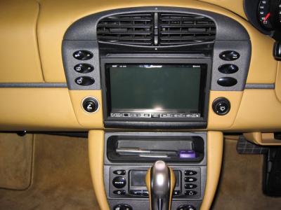

In any regard, I put an AVIC-Z1 in my 2002 Targa and it works and looks great.
My only quibble is the glow on the buttons is blue, whereas the rest of the car is amber. A small thing, I know, but somehow annoying nevertheless.

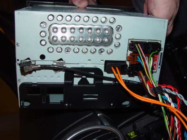

How about this? There should be a MOST fiber optic connector, and then 3 regular connectors (with copper wires) that plugs into the back of the PCM 2.1 head unit. Attached is a photo of the connectors. I'm assuming that one of the copper leads is in fact an illumination wire, but I have no way to tell. If you can find the pin-outs for these 3 connector, or just the one that is illumination, I'd appreciate it.

Sorry, none are an illumination wire.
From looking at the schematic it would appear that the PCM unit get a network signal over the CAN bus to turn on it's own internal illumination.
