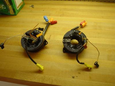

Im having the dreaded flimsy weak bushings on the Horn grounding plate. My problem is after removing the airbag and plate assay. from the steering wheel, there is a broken wire. The horn is a basic two wire concept, the One wire that attaches to the blade contact of the horn plate is OK. There is another with I noticed that did not go into any thing and was cut clean, Its brown with an orange stripe coming from the far end of the connector main connector plug coming thru the steering wheel.

A tip as an extra wire that is cut and goes to nothing. It is red with a yellow stripe. No clue why there is that wire, because a manual transmission does not have it.
You can see the cut wire in the left of the picture, pointing in the direction of the blue connector.

TP,
Thanks, since I have a Tip car, that looks about right. Im just not used to seeing cut wire that do not go to any thing.
