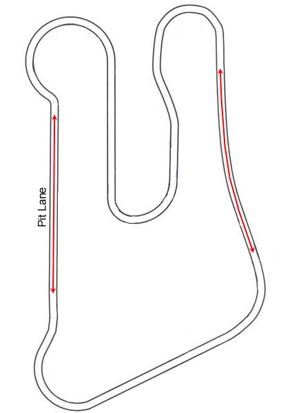

there's a course map and a couple of pics below. hope you all find this helpful. take care.

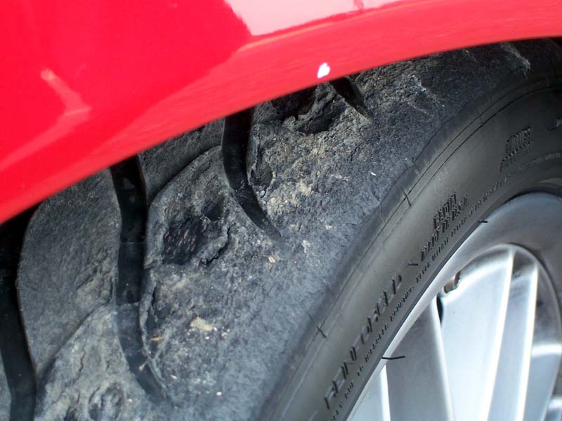

the pic below is after two 20 min track sessions. btw, since adjusting my front camber, lateral grip has gone from 1.09G to 1.21G.

If I read you correctly you are now using 32 psi cold on both front and rear, am I correct? After several track sessions my front tires look like your picture, using 30 font and 37 rear. I am going out this weekend and my try 32 psi cold all around, I would like to reduce the understeer.
insite
i'm using 32 cold front and rear. prior to increasing negative camber, i got WAY too much understeer with anything less than 35 -36 cold up front (the picture shows how well that went). setting the front camber to -1.6 and dropping my front tires to 32psi has corrected the understeer problem and evened out the temperatures across the tread.
