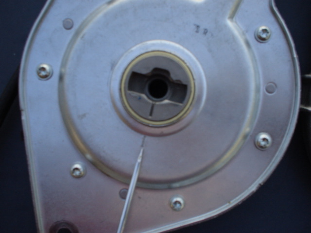

Your car has the new style transmissions, and the local owners are use to dealing with the old style.
I think with the new style you have to line up the 2 alignment marks on the transmission, like in the pic below. A mechanic I know at Stevens Creek takes the transmission out and takes a drill to the cable to get the marks to align. Then the transmission is bolted back in. The cables are then connected to the motor. The V levers are bolted in. The push rods are hooked up.
I have not done this myself on a new style transmission car, but watched the mechanic do it. Told him I thought is was too much work to do it that way, but then I have no experience with timing the new style transmissions.
On your car both sides need to move together, and they must be aligned. I do not know if you have a problem with a cable or a transmission or something else, without seeing the car.
