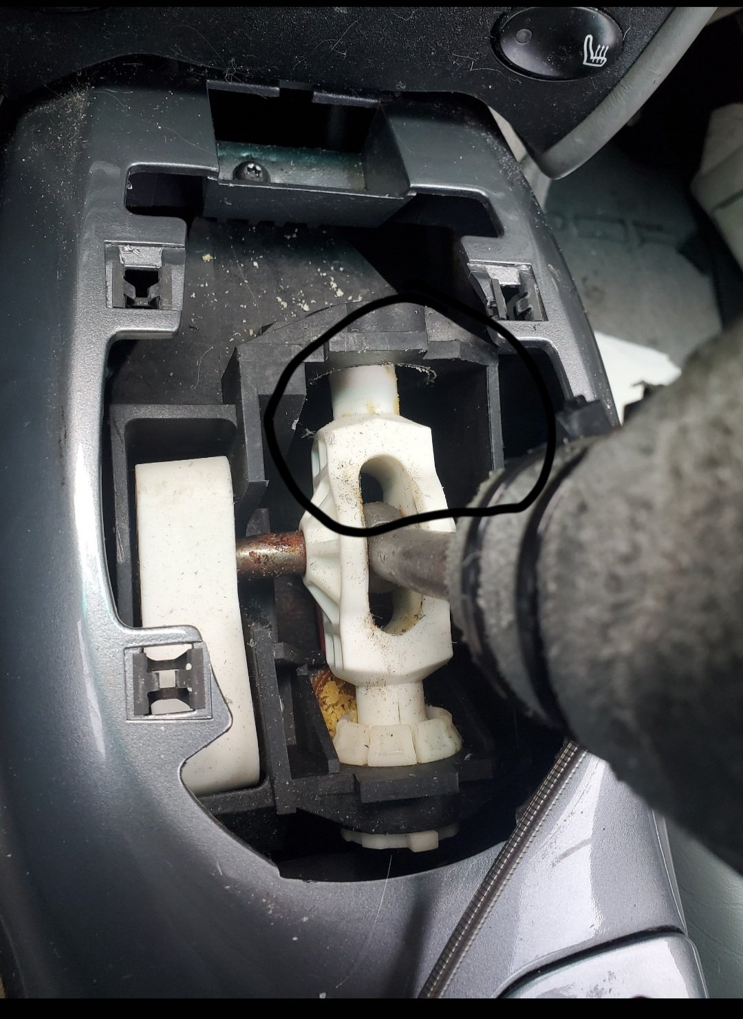

Just an update.  996/986/996TT gear shift bracket is now Porsche suggested retail $482.00

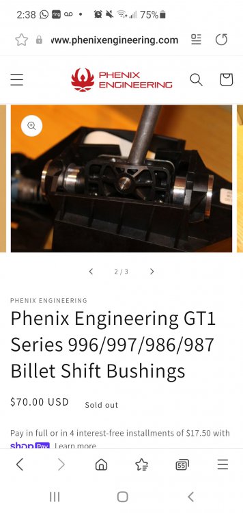

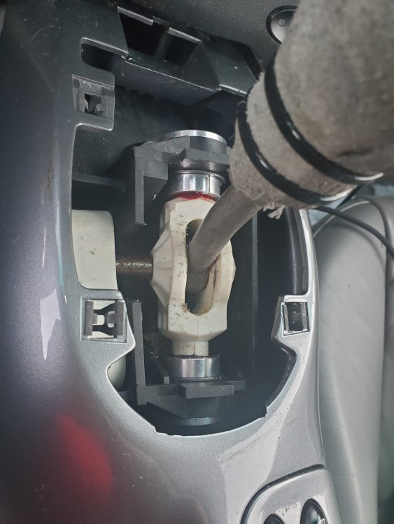

I had valet crush the front plastic bushing and Porsche still doesn't sell just a bushing and neither does Evo anymore it seems.   But I found a reasonable solution as shown in other photo. Phenix makes aluminum replacement bushings for $70/pair.  Easy installation and works great.  I bet never a crushed bushing again.
