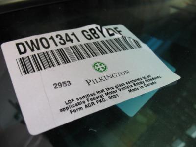

I just had my windshield replaced and I was told it was an OE windshield but the manufacturer is Pilkington and not Sekurit like the OE was. On my invoice I have the following part number, can someone tell me if this is for a replacement windshield or what this number could be? 986-541-541-029A4-FW2029 = OE Glass 982-541-039A3 = mold kit Thanks!

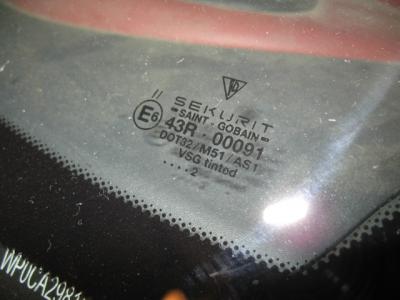

Saint-Gobain Sekurit is the company that makes the glass for Porsche. http://www.saint-gobain-sekurit.com/en/index.asp
If you look at the pic of my car you will see a triangle with a funny looking P in the middle above SEKURIT- that is the Porsche logo used on parts. This is the windshield put in my car 2 years ago. The body shop purchased it from my local dealer. And I know they did because I happened to be in the parts department at my local dealer when windshield ordered by the body shop came in.

Never heard of Pilkington aftermarket glass being used in a Boxster, just PPG. Might be something new.

Maybe your shop ordered the wrong glass. Would like to see a picture of the Pilkington logo on your glass.

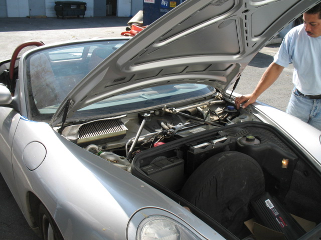

We strip all the plastic trim off that needs to be removed, the wipers, and so on, waiting for the glass to arrive. This prep takes about 15 minutes if you have done it before.
No glass shows up. It is on the way. They offer me a ride to the office but I already have a ride once I call the office to fetch me, but only after I see the glass that they want to put in. I tell them they are not to cut out the cracked windshield until I approve the replacement.
So, one of the guys at the shop goes to fetch at the warehouse. Then they want to know how many wires I have in the windshield. I told them over a week ago I just had just the standard antenna, no diversity, no rain sensor, no self-dim mirror. So I then remove the windshield mirror to show them.

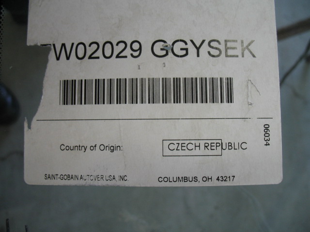

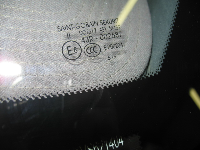

Well, 2 Sekurit windshields show up today. Hope it is not a bad omen that I am going to crack another one at the Laguna Seca drive this Saturday. Both had the mirror mount and antenna wire.
If there is a difference between my replacement Sekurit glass and the Sekurit glass sold by the dealer, then all I can see is that there is no Porsche logo on my glass. There are no distortions in the glass, and it fits just like the 2 prior windshields.

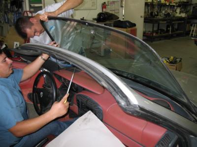

I have a 1997. The newer cars need a moulding/seal kit unless you can reuse the old one. My 1997 just needs a rubber seal that goes around the glass. This seal is glued in after the windshield is installed. My seal was replaced 2 years ago and we were able to reuse it because it had not been glued in back then. I waited an hour on the urethane and then took off with windshield #3.
Glass $325. Labor $80. Urethane glue $20. Tax $28.46. Total was $453.46. The guys at the shop did a good job and I am happy. No Porsche "bug" on the glass, but I think it was bad luck for me anyway....
