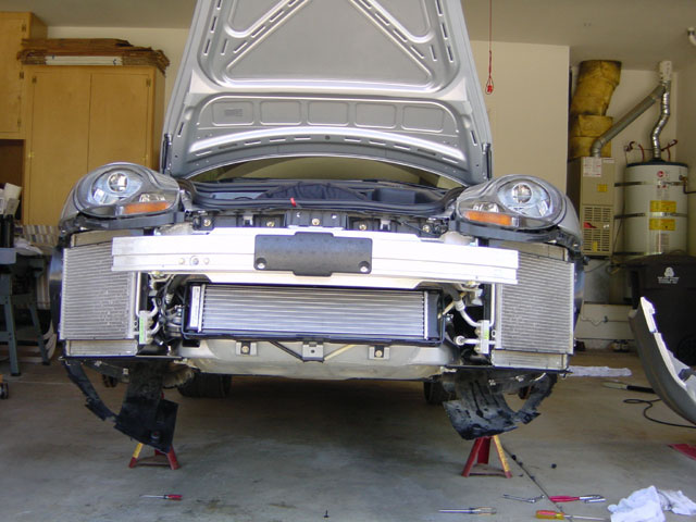

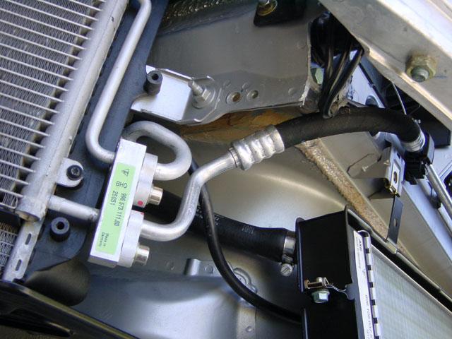

Yes, you will find an AC condenser in front of each radiator behind the bumper.

Wow Loren
Thanks for the excellent pictures. That is a big help to me. Lets hope when the garage remove
the bumper its only a pipe that needs replacing??
Thanks again will keep you posted.

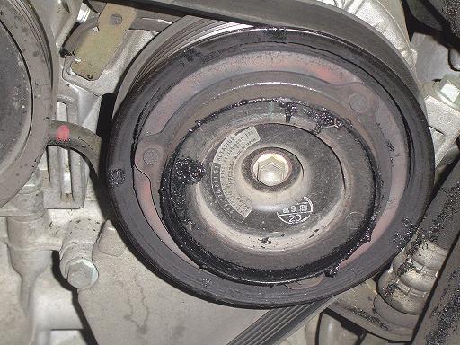

I was driving today 00 996 C2 and my A/C went warm. I got home and inspected around the motor area just in case I ran over something, but then I found this on the A/C compressor like something burned around the whole pulley area...like burnt rubber what can it be?
A/C turns on and off, I hear the clicking of the compressor and air is blowing and hear compressor in the front. I might just recharge the A/C before anything else is done. Which port is it though left or lower right one.post-28718-1217379925_thumb.jpg
don't waste the money on a recharge...your compressor clutch is shot.
