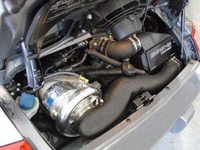

Well guys, it may be time to bring up the discussion topic of supercharging our NA 996s again. Evolution Motorsports is offering a group buy promotion right now with discounts of up to $2000 per unit if 11+ units are sold (we can get together with some guys from 6speedonline to do a purchase). At around 8k, they become much more tempting to me personally. Evo has now sold 150+ units and claim to have, thus far, not had a single motor destruct.
So, first, if anyone is interested, I will start a list of names and can coordinate a negotiated buy to give us the best possible pricing. Anyone interested can contact me at: bigbonebob69@yahoo.com
Second, if anyone has any feedback from their evo supercharger install, or any tips or musings, please let us know. Also, if anyone has a cometing supercharger, please let us know why you went with another manufacturer.
