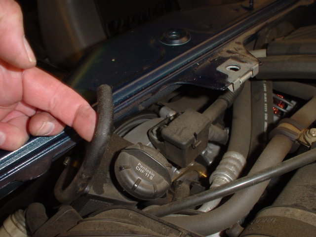

It is a vent tube for the power steering reservoir. Does not connect to anything.
I seriously appreciate your help. Thanks much for the picture!
