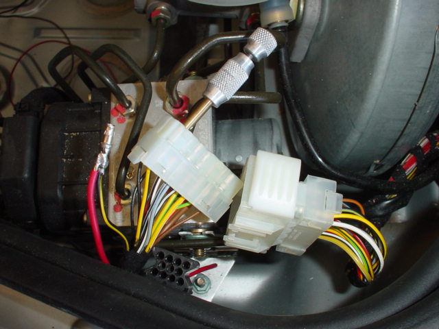

There is a white 21 pin connector next to the brake booster.
Hi ToolPants,
I was taking a look yesterday, but was unable to find this on my 02 boxster. I looked in the front trunk area, underneath the plastic covers on the side of the battery. Am I looking for this in the right place?
Further forward in front of the brake fluid reservoir.
Hi ToolPants,
Oh okay, awesome... and then, how can I identify which wire is the correct one to wire up to the added on daytime running foglights? Just need a 12v pos and ground... I'm currently wired up to the sidemarkers, but would rather wire it up so that it comes on by itself with the ignition...
Hi ToolPants,
You will need to look at the schematic for your specific model year.
Hi ToolPants,
:unsure: Hmmm... So I flipped through the Bentley book wiring schematics, but was unsure which schematic to look up? Can you please elaborate in detail in newbie terms? (It is for a 2002 Boxster 2.7 5spd)
