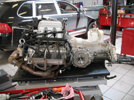

Had a phone call from another chap on rennlist with the same problem as mine. He is needing a new engine and is having it replaced this week.
Any others needing new engines or having similar problems? Comments are most appreciated.

5 months a go I saw a 997 S engine being replaced. The mechanic said it had broken piston rings. I think he said it was just one cylinder.
I guess if just one bank is burning oil then you are going to have more soot in the tail pipe for that bank.
