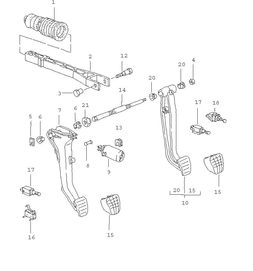

There are two switches on the clutch pedal. One is the start inhibit switch, which must be working otherwise the car wouldn't start. The other is the cruise switch.
In the picture the two switches look different (16 & 17), but I don't know which is which. You need to check that they both work when the pedal is depressed.
It would also be worth checking that you are getting 12v +ve to the stalk - the black wire going to pin 2 of the 4-way plug.
