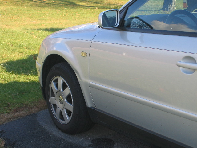

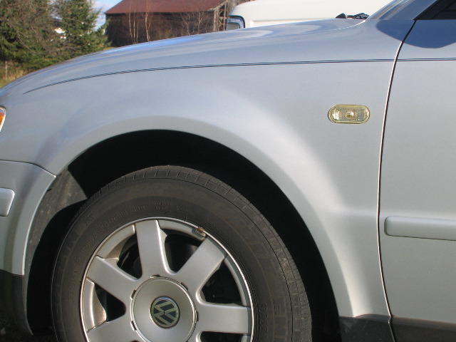

SO...when one of my gooood-running cars, that didn't have a mark on it, was rammed by some teeniebopper, I took it to Dent Wizzard. I was willing to settle for a less-than-perfect repair in exchange for not needing half the car repainted. However, even on this difficult repair, it is nearly perfect. They did no paint work. Cost was $170 I think. Body shops wanted $450 - $700. Check it out - rear of fender lip.
