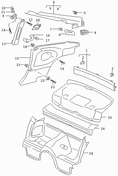

Guys -
I'm looking for a drawing or photo that shows how the trim panel that extends from the back of the carpeted rear package shelf up to the base of the rear window is attached. I believe it is the source of an annoying ticking type noise. and I can see that the center clip is pulled out, however, when pushing it back in it will not fasten correctly and stay in place.
How is this black vinyl panel attached, what do the clips look like, and how many and where are they located.
I figured I better ask first before I start yanking on things. Thanks in advance for your help.
Opps. MY 2000 996 coupe.

There should be 5 clips (item 2).
Is this the same for the 997 S shelf? I want to access the rear wiper assembly to remove the motor and do not see how this rear shelf is held in place. Any help would be greatly appreciated....Thanks
