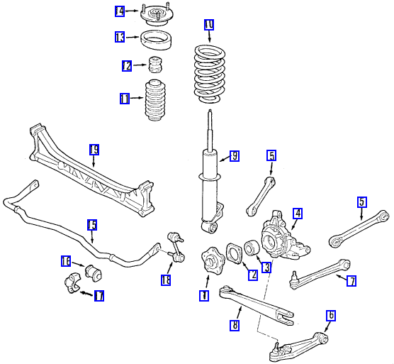

can i use the cross member (#19) in the rear?

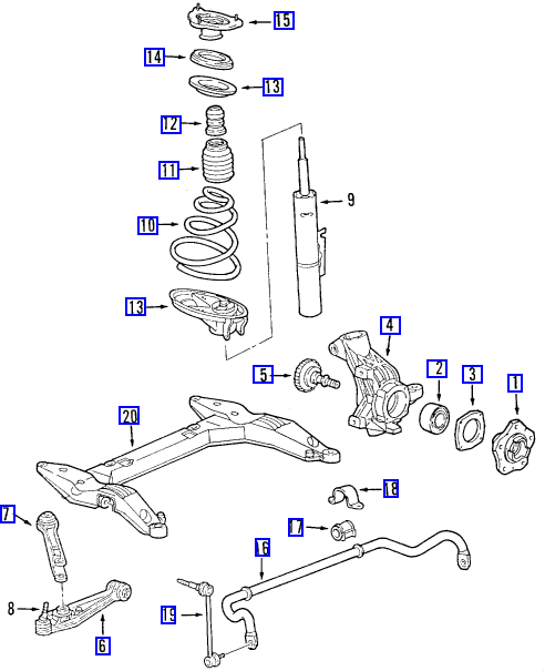

For the front, they do not recommend using the sub-frame #20 to jack up the car. Besides, it's covered by a plastic panel, so you'd have to remove that first. (IMHO if you absolutely must, use the jack at the point where the sub-frame is bolted to the chassis, but that would obviously be off-centre.)
For the rear, the preferred point is the oil pan, but use a piece of wood between the jack and the oil pan. The factory recons that you could probably use the cross-member #20 at the rear, but the oil pan is preferable.
