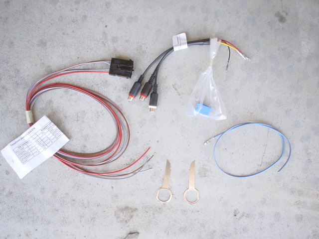

I found the cable on the Becker website:
BeckerAutoSound
(Go to "What's New" on the left side of the window)
"Porsche owners:
We now have a Telephone power cable, 5001.524-276. This allows power/phone mute to the existing car wires without any cutting. The price is $5.00 (list).
To order please call our parts department at (888) 423-3537 x1209"
I guess I'll be calling them on Monday.
--Louie
I installed a SonyEriccson Bluetooth module in my 04 Turbo Cab. It works with the same four wires and hides in the dash. HCB-30
Here is a picture of everything pulled apart and the Bluetooth module hanging to the left of the shifter.
I put the control on the "Bat Wing" piece just in front of the shifter.
I had to use the Techart speaker base because I have a car with the MOST bus. If you have a 02 or before you could actually send the sound from the Bluetooth module through the right side of the sound system.

I mounted the microphone just behind the steering wheel. It is real easy to run the mic wire back to the module in the center consol. The wiring is simple. You have one that wired to ground, one to switched 12 volt, one to 12 volt, and one that mutes the radio. Then there is a speaker wire and mic wire, so it is pretty simple.
The PCM II module or any of the Porsche radios will mute when you get a phone call.
