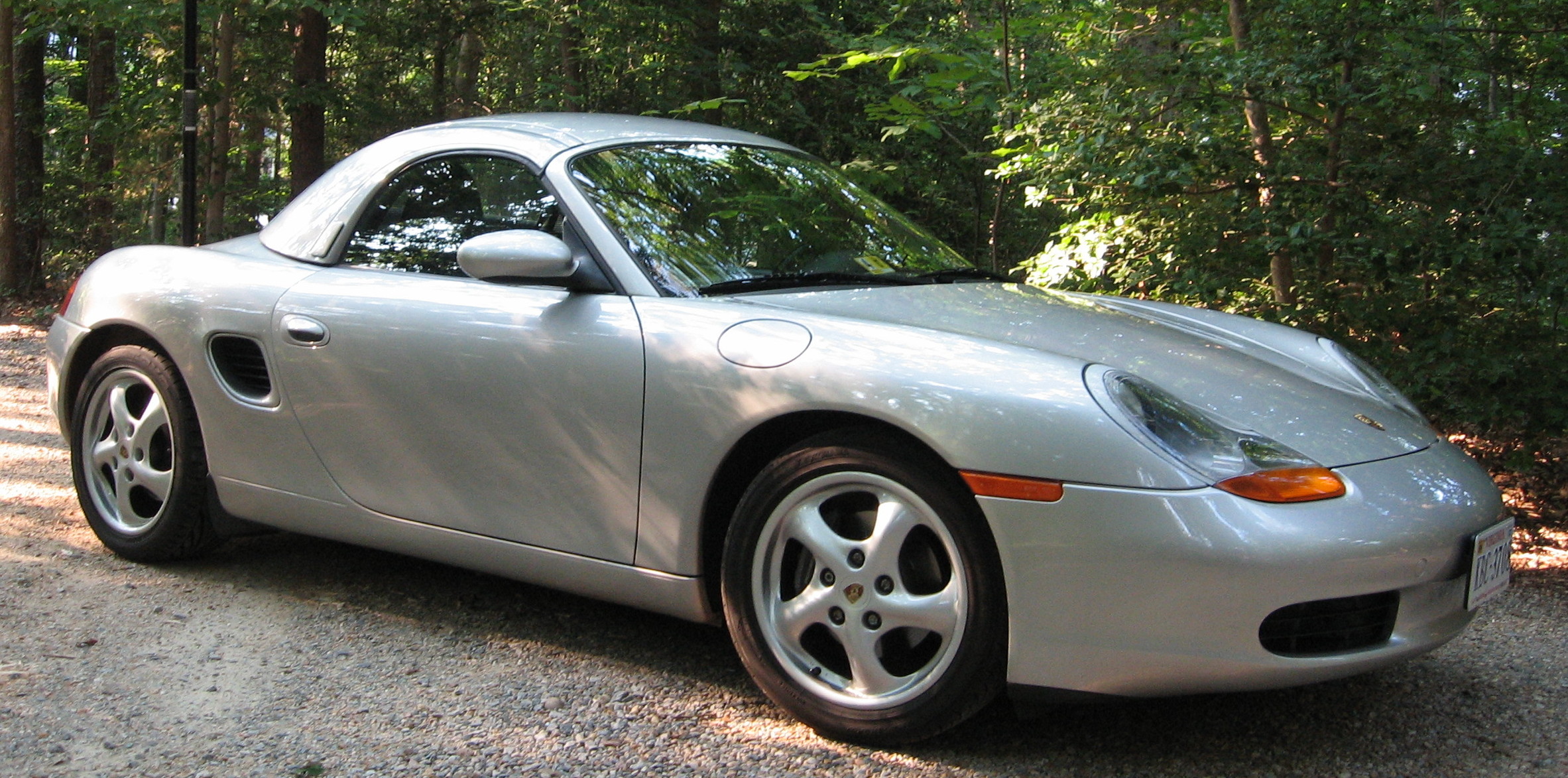

When I picked up my used hard top at the beginning of July, I had a very difficult time attaching it to the car. The seller and I tried three times before we fitted it correctly. (I have to admit I was becoming worried about it because I was 300 miles from home on a rainy night.)
I left on vacation two days after returning from my hardtop retrieval mission, so the top stayed on the car for about three weeks before I removed it for the remainder of the summer. When I reinstalled the top two nights ago (the temperature here is dropping into the thirties at night) it fit on very easily. Part of the improvement may be attributable to expeience, but I think the top might also have adapted to the shape of my car during the time it spent attached in the warm summer weather.
My recommendation is that if you can get the top on the car, wait to adjust it until it has had a chance to settle.post-9357-1162524958_thumb.jpg
I agree that a silver hard top on a black car would not be as attractive as an all black car. A black top on a silver car might work OK since it would be similar in appearance to a black soft top on the same car. Overall I think the matching hard top contributes to the feeling of having two cars and I think it would justify the cost of a repaint.
