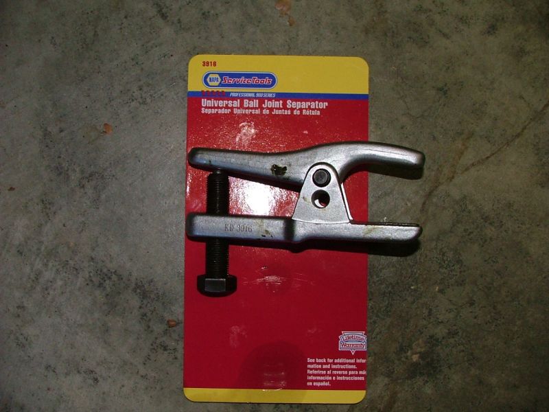

NAPA has one for $18. Its part number 3916.
Works great!

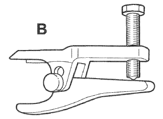

Put the forked part between the control arm and the ball joint, with the "finger" part on the end of ball joint threads. When you turn the bolt, it's supposed to push the threaded end of the ball joint back through the control arm...
I hope that's clear enough, if not we'll try again. :)

Just got back from NAPA and all they had was this tool....775-9096
Course mine is not black like in the picture.
http://www.napaonline.com/MasterPages/NOLM...Joint+Separator
Did i get the right tool?
Thx
Share this post
Yup, that's the right one.
I just had to use one of those yesterday. It does work, but it is more difficult to seat on the balljoint. Also, you have to be sure to leave the nut screwed on the balljoint so the top of the threaded shaft is level with the top of the nut.
Good Luck

I got one from Sears. $19
http://www.sears.com/shc/s/p_10153_12605_0...20070921x00003a

I went to advance auto and the tool they have to rent is the same as the one i have from napa.
I can't get the ball joint connected to the control arm seperated from the hub that is behind the rotor.
I am getting a little stredd b/c i can't find a tool to get this finished.

I had trouble with the napa one - it didn't seem quite long enough - the lever did not sit fully on top of the threaded rod. If it is not fully on the rod, it can crush half of the rod.
I like the Harbor Frieght one better, although the bottom jaw needed slight widening with a file.
Also, you need to disconnect the drop link and the tie rod to turn the wheel carrier to get the right angle on the lower control arm to get the tool in. You also need to smash the rubber boot down so the jaw id up against the metal cone.
