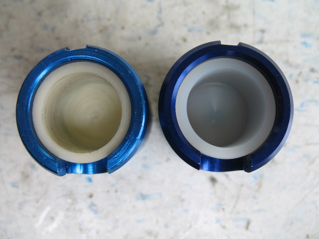

This is a problem. The inside diameter of one of the cup bushings is too large. The other bushing is ok, a snug fit like it should be. Strange that they are not both machined the same. If I was to put the shift in a car with that bushing the way it is the lever would rock.
Thanks, I'll take a look at mine and let you know what I find. Any idea how much it would cost to have bushings made (if need be) to fit the tolerances? Seems like a fair # of people have purchased this kit so as mentioned above, maybe we can get a group buy going on this.

I bought the knock-off from the ebay seller a2rinc for the comparison test. The seller is in Addison, Texas. I sent the seller pictures and a video of the poor fit of one of the plastic cup bushings, and the seller expected me to find him/her a source of proper fitting bushings???
Anyway, Alex provided a new in the box B&M today so I could compare it with the knock-off.
Just for fun, I removed the lever from the knock-off and reversed it 180 degrees for the third picture so that the bend is to the right, as if it was to be installed in a car.

I have put in a lot of B&Ms. The first thing I check is the fit of the cup bushings. They are not always "exact" even with a B&M. So, with the $55 unit, the first thing I did was to check the fit of the bushings, just like I would with a B&M and even the Porsche clone. But I have never seen such a sloppy fitting bushing like the one I measured - I could tell with my eyes the diameter was too large.

Can you confirm the measurements are 15.7 and 16.2 (appears to be a reflection on one)? Did you measure the pivot arms of the shifter too? Curious to those #s.
Confirm 15.7 and 16.2, but there is also a taper, so it depends on where you measure the inside diameter. I think I will take some pictures of that condition when I get a chance.

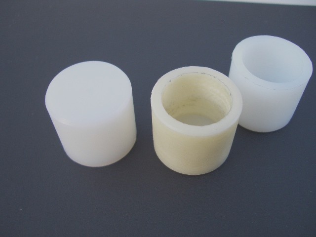

I just bought one from iA, and I was told it is a B&M. However, given the fact that it came in a bag rather than carded, that there were no installation instructions included, and that the bushings are made of nylon, I think it may actually be a knockoff. B&M uses Delrin for the bushings.
The bushings in this kit both measure at 0.617" ID, and do not appear to have any appreciable taper or concentricity issues. However, I do know that there is a difference between nylon and Delrin that may affect shifter performance. Nylon is hygroscopic, and is not nearly as dimensionally stable as Delrin. Simply put, this is to say that nylon will absorb moisture and change size in response to that, Delrin will not.
Isn't that just odd? I don't know the price differences in the bushings material, but it can't be that great. When such a small thing can make such an impact. Hmmm. I guess I'll stick with the B&M or OEM upgade.
Delrin rod stock is about 3x more expensive than Nylon, and a little bit harder to machine. It yields a better bushing though: more durable, more dimensionally stable.
If these are truely B&M knockoffs, and they have been reverse engineered from a B&M unit, then you could always buy a set of replacement bushings from B&M to get the Delrin ones. I'm going to try that route before I have someone machine a set.
