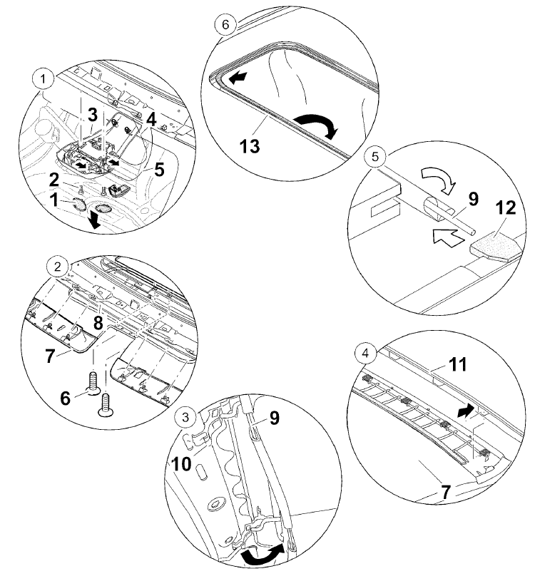

Can anyone help with detailed instructions and/or diagrams of how to remove the headliner?? I have a sunroof if that makes any difference??
The reason for removing it is unwanted 'rattles' when driving over bumps in the road (sunroof plastic rear wind deflector rattling on metal of roof i think) and vibration from Bose speaker on headiner above rear screen.
Would assume headlner out is the only option to fix this?? Doing my head in, please help???? :(

Removing interior light cover
1. Using a small screwdriver, carefully unclip both cover lenses 1 at the openings provided.
2. Undo fastening screws 2. Unclip cover 3 at the rear left and right, push forward towards the windscreen and remove.
3. Disconnect the electrical plug connection of the sliding roof rocker switch 4 and the interior light 5.
Removing sun visors and brackets
Unclipping front plastic lining
1. Undo fastening screws 6 in the plastic lining 7 at the front and unclip the lining out of the cowl panel frame 8 in a downward direction at the left and right.
Detaching roof liner at sides
1. Unclip the metal strut of the roof liner 9 from the plastic clips 10 at the right and left.
Disengaging rear plastic lining
1. Pull the rear plastic lining 7 towards the rear out of the roof frame 11 evenly on the left and right and disengage.
Disengaging metal strut
1. Pull the metal brace 9 contained in the fabric pocket down in the center so that it bends. Pull the metal strut 12 out of the bracket on the left and right.
Disengaging frame
1. Pull the frame of the sliding roof cut-out 13 backwards and downwards in the center at the front so that the frame overlap at the corners is reduced and it is possible to pull it out in a downward direction. Then pullout the roof frame diagonally via the sliding roof cut-out inwards into the passenger compartment.
Install is the reverse.
