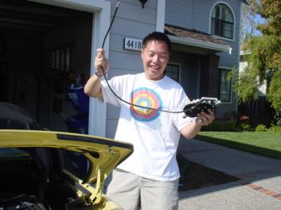

There are 3 nuts that hold the transmission to the body of the car. Remove those nuts and the transmission pulls away from the 3 mounting studs. You can if you want then unscrew the 3 mounting studs. Sounds like the sheet metal is bent if one transmission is not flush when bolted in. I used German Auto Body when my car got hit.
The new style transmission started for model year 2000. If you put in this transmission then you need the mounting studs. The mounting studs for the old and new style transmissions are different.
Met David today, and it was bent sheet metal on the passenger side transmission. Therefore the transmission was not vertical, but on an angle. Due to this angle you cannot get to the top 13 mm nut with a standard socket or a standard combination wrench, and those were the only tools we had in my office parking lot.
The driver's side transmission was fine and it came right out.
