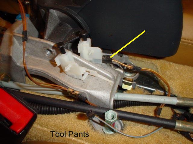

Your clue is to replace the handbrake switch.
Thank you Tool Pants. You are right. The handbrake switch was loose out. Yesterday, I connected it back and my top works.

Replace the switch. Part number 996 613 112 01. Then report back.

Toolpants,
Hate to be a dummy on this one, but how do you get to the point which your photo shows?
Thanks
Share this post
you are not the only "Dummy" :-)
can someone write detailed instructions on how to get to the microswitch and replace it?
i hate that stupid switch....

Ok, got a new switch, followed the short shift instructions to remove the console, replaced switch - IT WORKS!!
