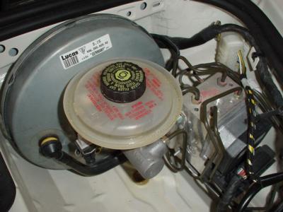

Looks like Lucas does the brake booster, not the electrics.
