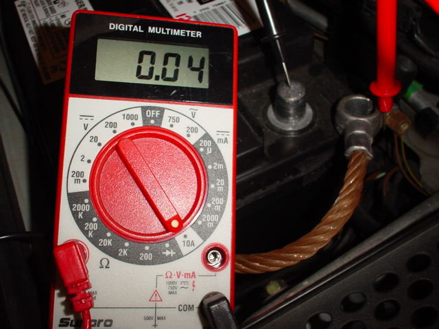

I'm not sparky, so Peter told me to test for draw like in the picture. In fact, I think I should have turned the dial to mA and not the larger 10A scale.
Before I hooked up the meter I closed the trunk latch with a screw driver in order to turn off the light.

Sorry, Bro, amp clamp only works for AC current. You need to hook the meter in series and set to DC amps, like I told you earlier. Clamp works by induction. AC induces current. DC does not.
Try disconnecting fully charged battery for a couple days to see if it holds a charge. Feel free to E-mail me if you want.
