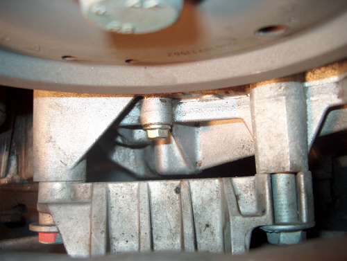

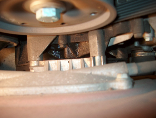

My 1999 Boxster with 60,000 miles has a film of oil on the bottom of the unit where the water hoses attach to the engine and a drop of oil on the bolt that I think is the water drain plug. I took the engine cover behind the seats off and could see oil residue a few inches below the pulley attached to the crankshaft. I could not see well enough to tell if it was coming from behind the pulley. What do you think is causing a leak in this area. You can see the oil buildup in the center of the picture. It appears to be a very slow leak.

Here is a better picture with the oil cleaned away. I drove the car for about 15 minutes after I cleaned the oil up and no new oil appeared. I guess I will run it for a few weeks and take another look.
