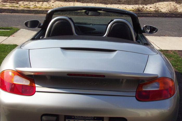

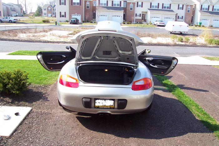

I need to see a picture of the rear of you car with the tunk lid open and closed, because your question makes no sense to me.
I've attached two pictures that were taken when I first purchased the car, so I picked the best two shots that line up with what you're asking for.
Thanks.

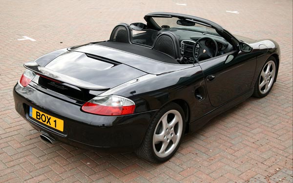

This is AeroKit I.
On it, the electric spoiler that moves up and down is removed and a plastic plate takes it's place. To fill the gap left by the movable spoiler a longer tunk lid made of plastic is installed.
I now think I am confused by "I" and "eye."

This is AeroKit I.
See, there is a factory Aerokit I and II, and a combination of both.
I was told that the factory Aerokit I when it initally came out looked like the picture you just posted. They removed the cap on the spoiler (or the spoiler completely) and had a longer trunk lid to cover it. However around 2001'ish they started using the factory trunk lid, covered the 3rd brake light, and just disabled the spoiler. My car is a 2000 S, however it was sold in mid-2001, so most likely they just did to mine what they did to the other 20001's.

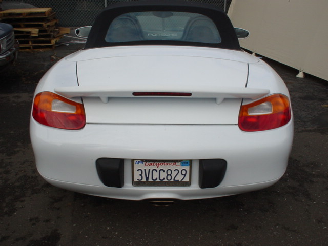

It was removed for the Aerokit I retrofit. No reason for the OEM moveable spoiler since it is replaced by the wing on the back of the trunk lid.
The white car is owned by local 1997 owner Mark, but the Aerokit was on when he bought the car a long time ago. Mark's car did not have this installed at the factory. It was put on after delivery and before he purchased the car.

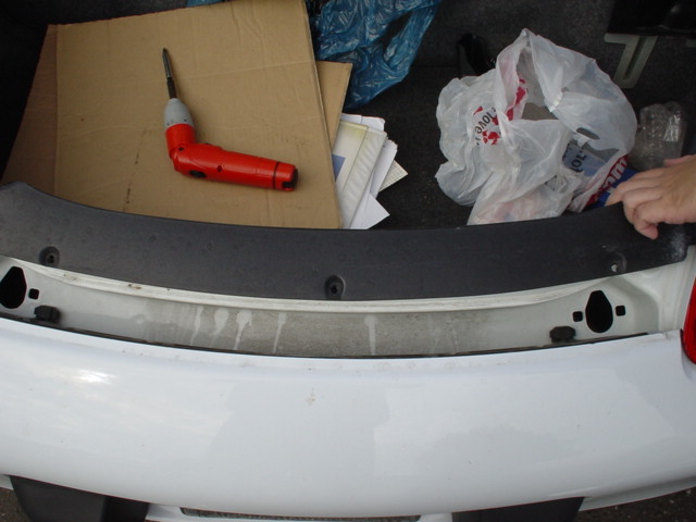

In this picture I pulled off the blaking plate on Mark's car to see if there were remnants of the original electric spoiler. Nothing there.
