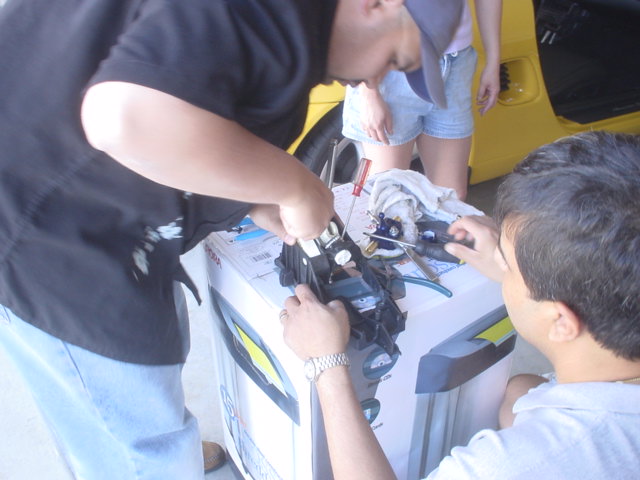

Try it - maybe you can figure out a way.
To compress all the tabs at the same time I have tried wire, hose clamp, and I forget what else. One time there were 3 of us trying to push down all at the same time. With 6 hands we still could not pull the bushing out.
