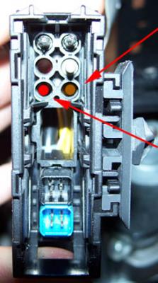

All of these harnesses were connected to the memory control unit. As you can see, there aren't any obvious connections for the power. The black and white wires on the LS, HV, and HH harnesses are slightly thicker than the red and brown wires. Does anybody have any ideas?
I think these go to the switches?
These go to the motors.

I don't have my camera available right now, otherwise I'd take some new pictures of the wiring on the passenger side. So, I'll see how well I can explain this. The picture of the harness below is actually of the driver's seat main harness, but I altered the picture to reflect the passenger harness. The passenger harness has two extra, thicker wires--one red and one brown. I simply cut these red and brown wires so they are no longer connected to the harness. Then, I spliced them together with the red and brown wires in my car.
It's as simple as that, the seat functions now.

There's a module under the front of the drivers seat that controls everything. You identified the motor wires in your photos, but not the switch wires. If yours is the same as mine, the switch wires are connected to a white/blue/black plug that has nine contacts. The bad news is that from what I can tell, the switches provide a contact to the PC board that with logic and relays controls the motor and its polarity. The switch wires on the passenger side carry voltage to the motor and are fairly heavy gauge. The switch wires on the drivers side are much thinner, and don't appear to be designed to pass the amperage required to run a motor.

I appreciate all of your help, but the first thing I noticed is that...I don't seem to have this plug you are talking about. The only plugs that I can see underneath my seat are the ones I posted in the photos earlier, and the main harness I posted a few posts above. Maybe you can tell me where this thing is at, but I don't see it. What year is your car?

I just noticed that in your "switches" photo, it appears that the small black and blue plug may be the switch plug. Not the plug and wires you point to, but the one to the right of it. Mine has a third section that's white, but it is for the lumbar control. I can't tell from the picture, but if the black and blue plug has a total of six connections, then I'm pretty sure it's your switch plug. If you have a VOM you can confirm it by following the pin guide I gave and check continuity when pushing the switch. Regardless, per my previous post, these switches can't control the seat like the passenger side. You need to either replace the seat switches and wiring or add new switches.
