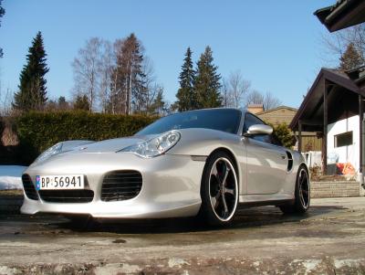

I have a minor change frotspoiler. This is a lip from Sportec , www.sportec.ch.
My painter integrated it totally in the original front.
This is how it looks.
