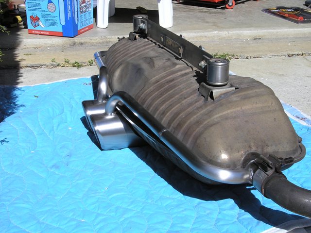

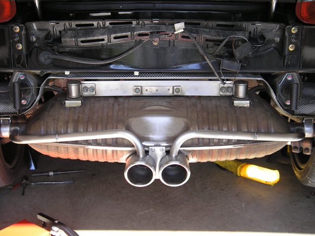

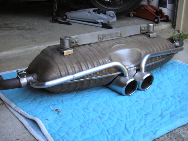

Well, it is done!!!! and boy, does it look nice or what?? and the sound, is superb!!! I have a friend who has an '04 911 Special Edition with the Porsche Sport Exhaust system and let me tell you that the sound is identical!!!
I have a couple of sound clips, I will upload soon. Enjoy the pics!!! Let me know if you would like to make this mod!
The car is still sitting in my garage waiting for the rear bumper diffuser to be installed, so I have not test the car on roads and highways. I only started her up and listen to the symphony!!!! As soon as I get her on the road, I will let you know if the interior noise changed.

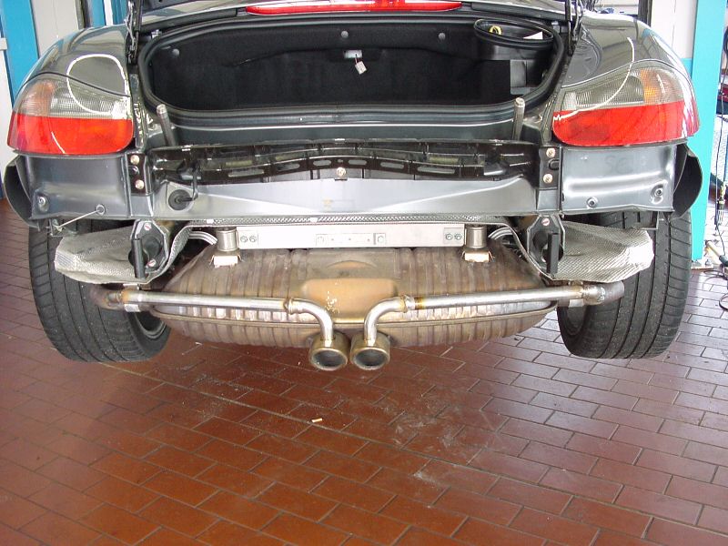

I got to hear one of those in person. You used a 2003-2004 muffler or the tip.
All this started with 2 German guys selling the modified muffler on ebay.
Share this post

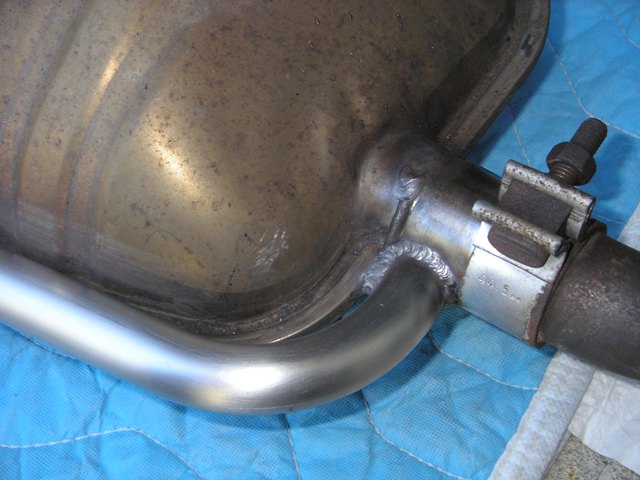

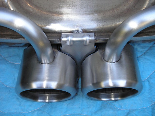

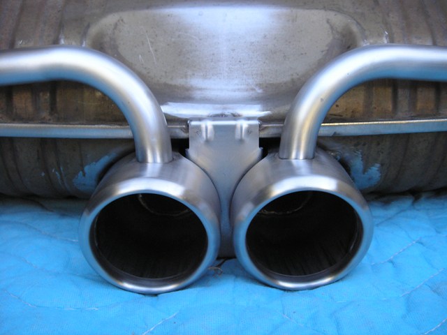

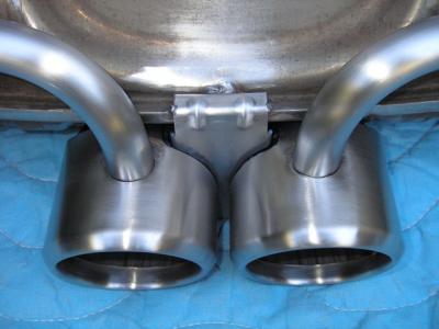

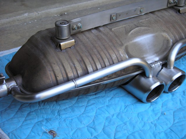

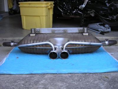

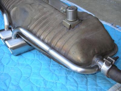

The tubes used are Stainless Steel T304, 1" (OD) 16 gage.
I used my original exhaust and replaced the tip. (see pic).
I need to check with my friend about the welding, I believe is MIG or TIG, something like that.
