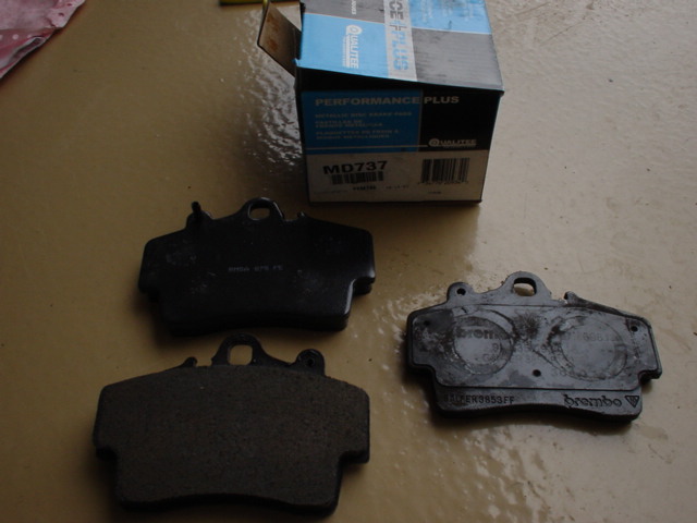

Try several import car parts places. We have a local one that sells aftermarket brake pads for $45. We put a front set in a few months ago on a base Boxster and the owner says they are fine. They are not fancy race pads for $200 or have the Porsche logo but fine for normal street driving. They also have the holes for the wear sensors.
I think they are sold under different names in the aftermarket. The name on the back of the pad is RMSA, which I think is Remsa of America owned by TRW. http://www.remsaofamerica.com/default.htm
The picture shows the box and 2 of the pads on the left. The single pad on the right is the old pad. The name on the box is Qualitee, but I have seen the same pads in a box with a different name.
