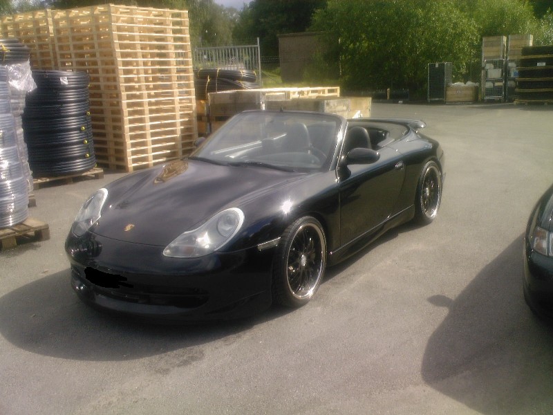

Thank you Loren This set got 52mm front and 65mm rear I will post pictures when i get the tyres

Man your car looks great! I like your choice of wheels. Also, What rear spoiler is that? Where did you pick it up?

The wheels fit great. 235-35 front E.T 52 285-30 rear E.T.52
Hi Mikke your car is realy cool...!
I just put deposit on a car in Hong Kong, similar start off point, 2000 C2 NB 911 cabriolet, black Mk1.
Can you tell me for your front and rear wheels, how much clearence do you have from (1) inside struts and wall (2) outer fender? I assume you didnt roll the fenders and not using any spacers?
The reason I ask is I have a set of wheels from my 987 boxster im dying to find out if i should try them on the car.
19x9 ET57 on 235/35
19x10.5 ET44 on 285/30 (tyres not yet purchased)
By my projections, i will need 5-10mm spacers on the front as my offset is too big.
And the rear it is a really right fit, my wheels will be sticking out another 2cm from you - so I doubt it will fit at all....
