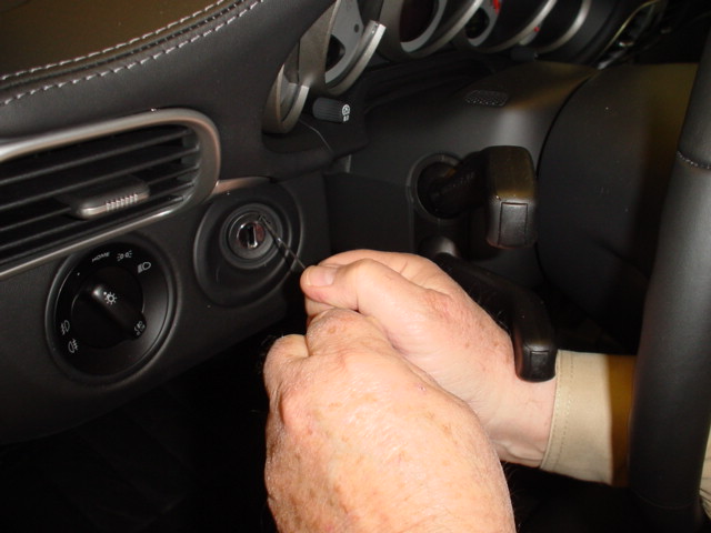

Try this. Behind the fuse cover there is a metal rod that is used to remove the key with a dead battery. You stick that rod in a hole next to the ignition switch. I think there is a diagram on how to do this on the whte folded paper on the back of the fuse cover.
Hmmm, my06 doesn't seem to have that tool. Are the dealers in the habit of removing this rod for some reason?

As for the metallic piece, dunno if the stealers have a "collecting" habit - but nothing special, a regular bike spoke or any hard wire would do the job...
