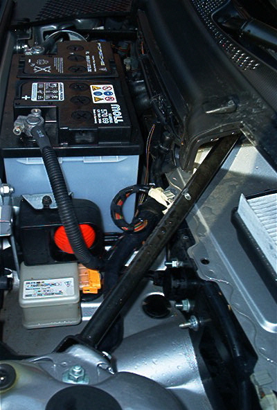

The pollen filter is in the area where the battery is. On a RHD the filter is on the passenger/left side. You can see the filter on the right edge of this picture.
