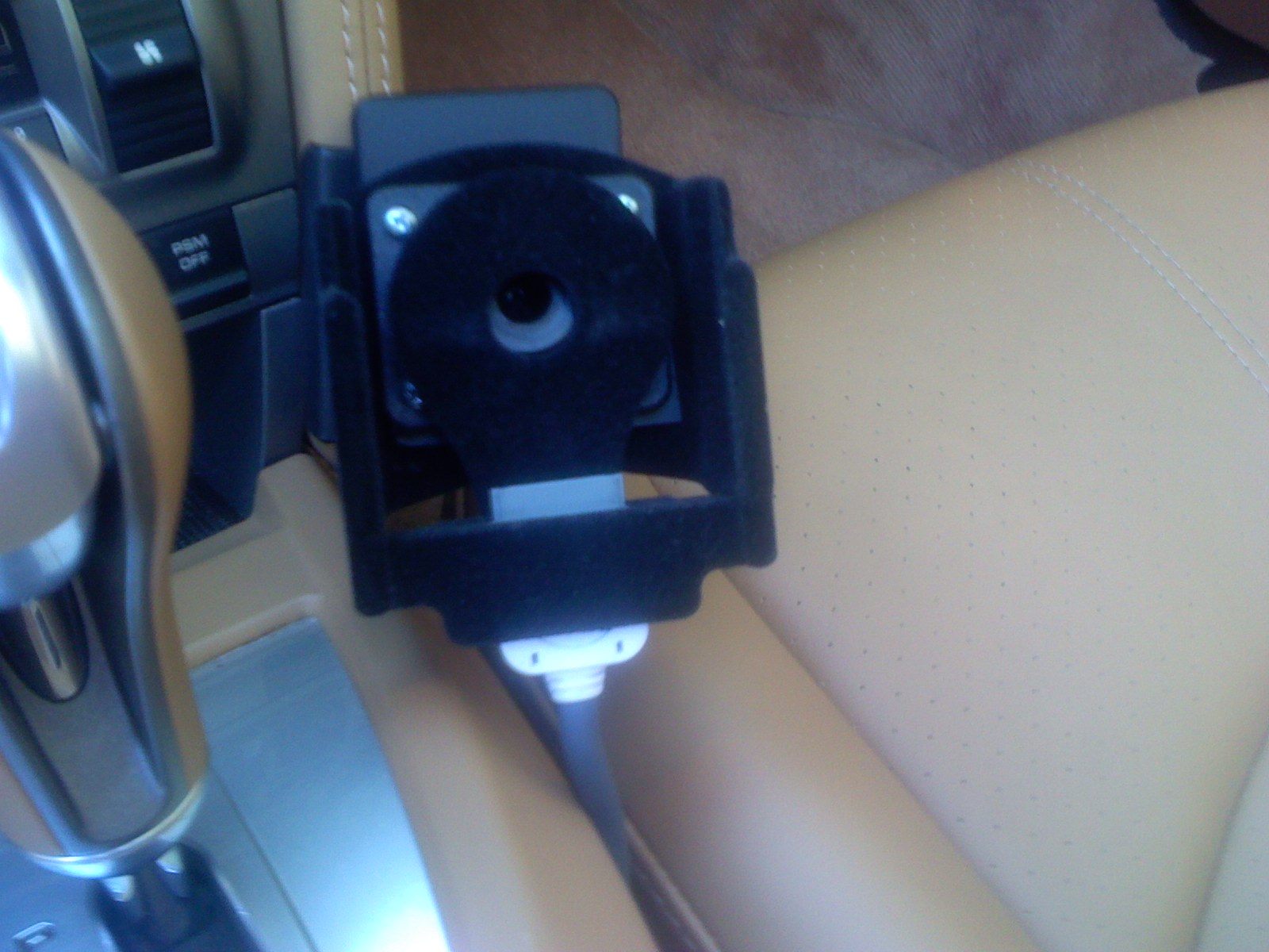

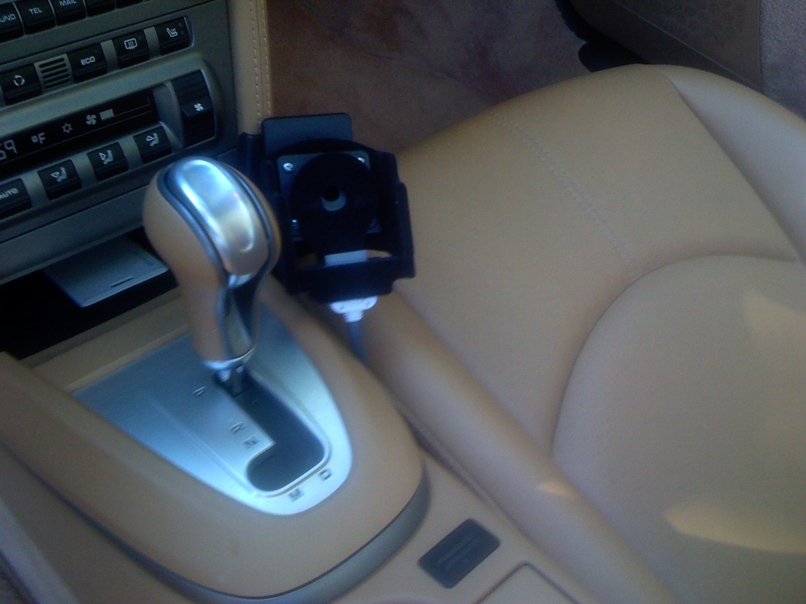

Some pics of the mount and connection...(ytaken with the iPhone, so it's not in the picture, but the munt is great because it's just drop-in and it's connected and held solid (needed for my style of driving!)
I did have to do a bit of mod work on the ProClip iPod holder to get a solid fit, but nothing my Dremel couldn't handle.
Hope this helps someone.
Damon

I picked up a proclip mount for my cellphone and couldn't get it mounted properly (it would fall off after a couple of days). What mods did you do to get it solid?
Thanks!
Yeah you have push the back (carpet end) waaay down and the front to the bottom as well. I had the same prob initially.
Hth
Damon
