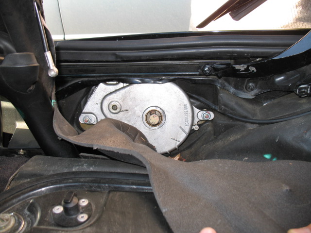

I know you said that the woman that you bought the car from said that she had problems with the top that she had "aligned". Is it possible that when the top malfunctioned with her, that the sheet metal supports on which the transmissions were mounted were either "torn" or "ripped" or cracked?
When you remove the air intakes and pulled back the lining, can you visually inspect that sheet metal to see if it's damaged? That might confirm that you have isolated the problem and are heading in the right direction. It is good that you confirmed that you have the correct spacer bolts and that the transmissions are tightly fastened.
Julian:
Hi Maurice,
Yup, both sides show damage, the driver's side more than the passenger side. The driver's side has cracks and holes in the sheet metal. My neighbour tried welding but his machine is not powerfull enough; besides I need to add some reinforcements to make it solid. It sounds like this might be the problem though. I will take it to a body shop and have it done right, whenever I find a good shop and the time to do it... I also want to do a full brake change (pads, rotors, flush), so I am not sure when I'll be able to get it all done. I'll be out of town for the second half of September too, so time is really a constraint here.
Thanks for your help and support with this issue,
Julian.
Here is the car I mentioned that we worked on in my office parking lot. I think it was a 1998. The right side transmission is on a angle because the sheet metal was bent. It was on such an angle that I could not get to the top nut to remove the transmission. The other side was fine and I removed the transmission.
I had been told that the sheet metal was weak on the early cars, but I had never seen it with my own eyes. I called a mechanic I know to see how they fixed this. Well, they don't. They send a car like this to the body shop first. We have a local body shop that the dealer uses so they are use to fixing this area, but I do not know what they do.
I know the body shop because they fixed my 1997 when it got hit a few years ago. One of these days I'll stop by and see what they do to reinforce the area.
Yup, I had a little bit of a hard time getting to the top nut myself. Oh, and the other two screws were broken! This was the old transmission, before I replaced it with the new style. I hammered the sheet metal back into a more or less straight position, but it needs professional help.

Julian:
Glad to hear that it looks like you found the root of the problem. At the very least, getting the two sides reinforced will only help ensure a more permanent and trouble-free repair.
As far as the body shop you use, after you explain (and show them) the way the original sheet metal is cracked and has holes, any competent body shop welder will be able to reinforce that area, and it will probably end up as overkill.
I don't think that you should have to remind them, but be very sure that they are aware to disconnect the battery before any welding is performed. The electronics can fry in a split second if they don't take that precaution.
If you can take photos of the repair, it might help some people in this forum down the line.
