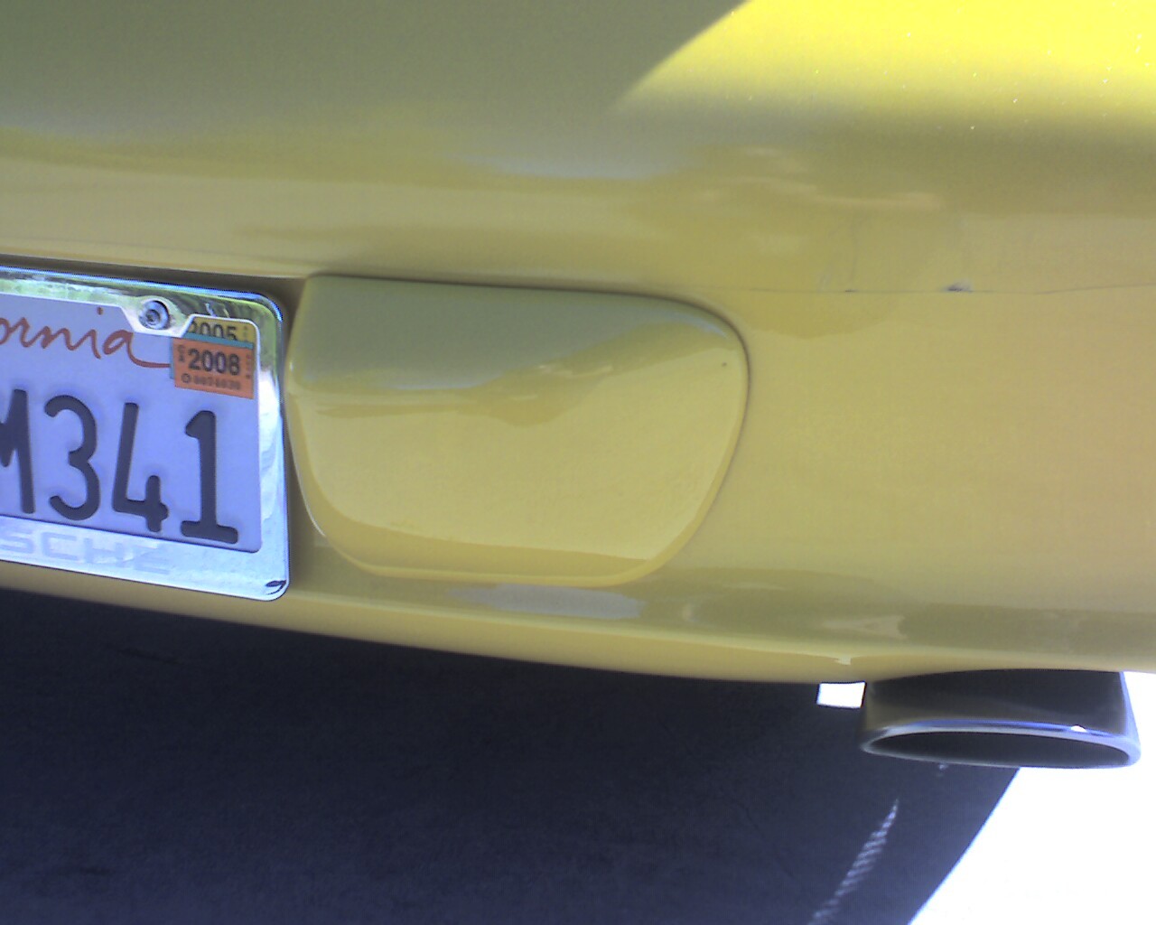

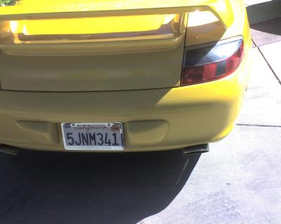

Okay, been trying to work with my local Porsche dealer on getting the correct bumperettes for my turbo look rear bumper. The stock ones form my 99 bumper do not fit it well. We ordered a set of twin turbo 2001 bumperettes but they were the same as my 99. All of the bumperettes in the dealer showroom all looked the same as my 99!
Then at the work on car day we had here in San Jose I saw another NB C2 with a turbo look bumper and the correct bumperettes... but he bought the car that way and had no idea that type they were. I have included pics, can anyone tell me the part number for this style? Thanks, David

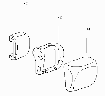

Thanks Loren, looks like I will need to use the newer supports too... hmm, makes me think I should just get the NR Auto polyurethane bumper and skip the bumperettes altogether. :lol:

Those are not TT style bummperettes.
Those alook like MY02 and newer Carrera bumperettes. Your bumper would need the slots and the support bracket (that holds them in place) to use these bumperettes.
