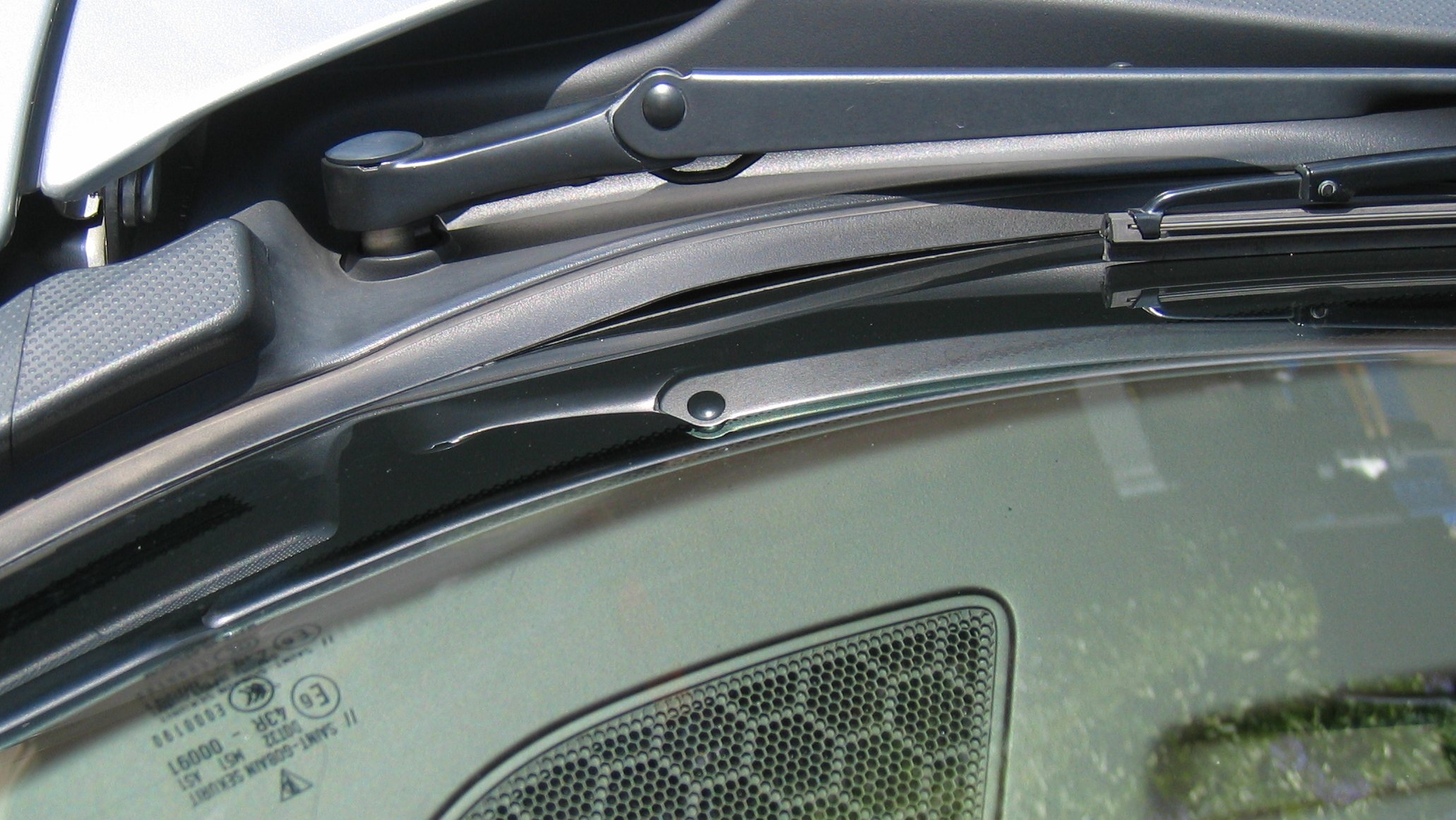

While washing our 2005 997 over the weekend, I noticed the windshiel seal seems to be separating from the glass near the driver's side windshield wiper arm. Here's a picture (you can see the separation between the wiper arm and its reflection in the window). It was taken looking down the windshield from the driver's side.
Before I contact the dealer to have it taken care of under warranty, I was wondering if anyone else has had something like this happen, and if so, any idea why it happened.
It is not a seal. The windshield is bonded to the frame. What is warped is just the top of the plastic cover that is between the windshield and the trunk compartment.
If your car is still under warranty, then your dealer will replace it. If not, it is just a plastic piece that you can replace yourself. It is held in with a couple of screws, and the wiper arms have to be removed to get it off.
