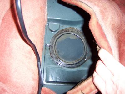

No problem driver side. Searched posts, noted probable drain hole problem, sure enough, under the clamshell (checked with clamshell in complete open service position) the drain hole in the foam surround part had leaves and gunk stuck in it. Picked at it with fingers and vacuumed, tried to poke further with wire hanger, would only go 2" deep. Hope it is cleared.

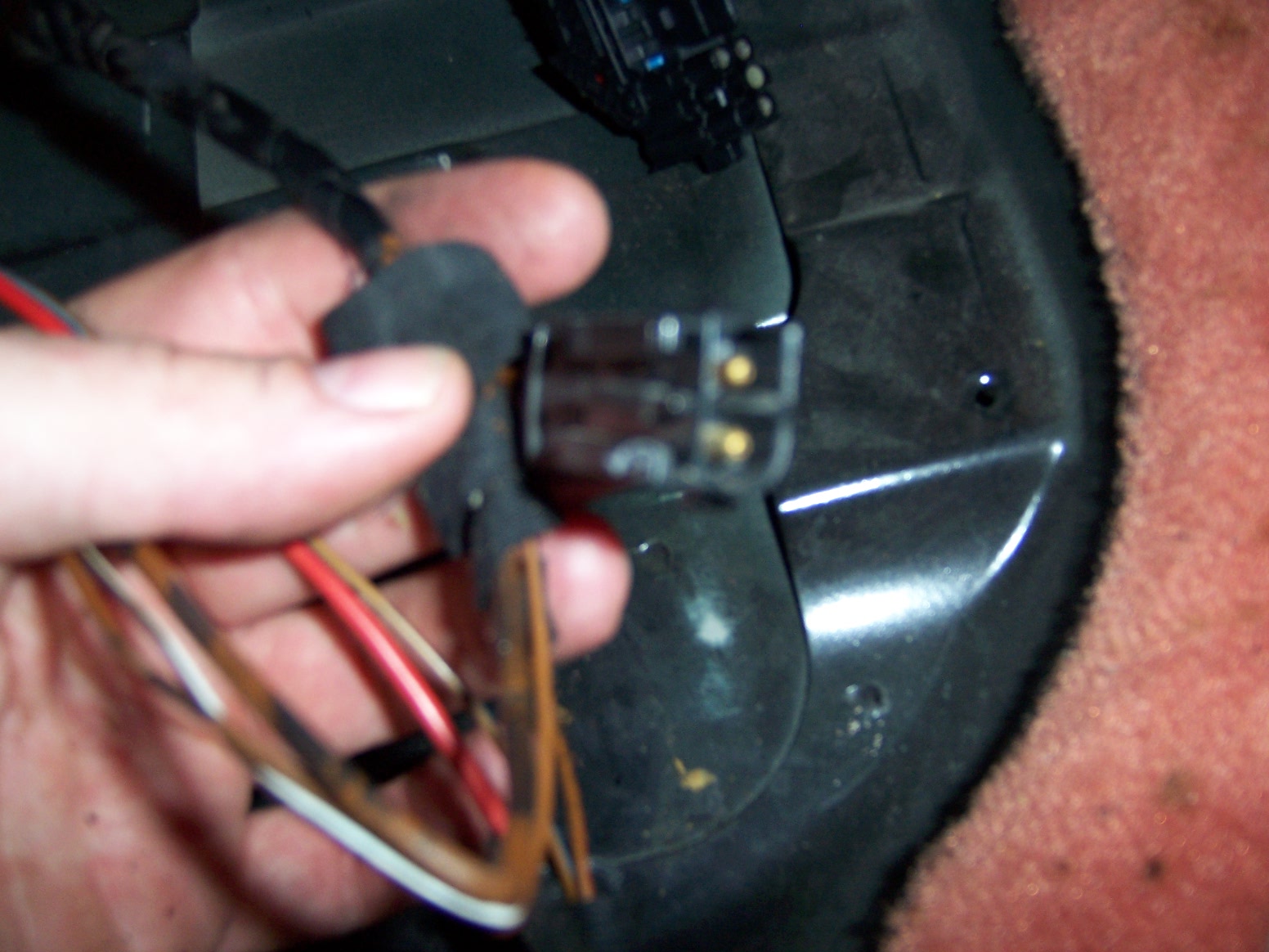

I am posting pictures of the electrical wiring plugs from the floor of the seat area, where I noticed a separate 2 prong plug that was not plugged
into anything (and some electrical tape on the wires, which is not factory, meaning someones been under there before me...:).
3- Does anyone know if this is the heat element switch on/off plug?

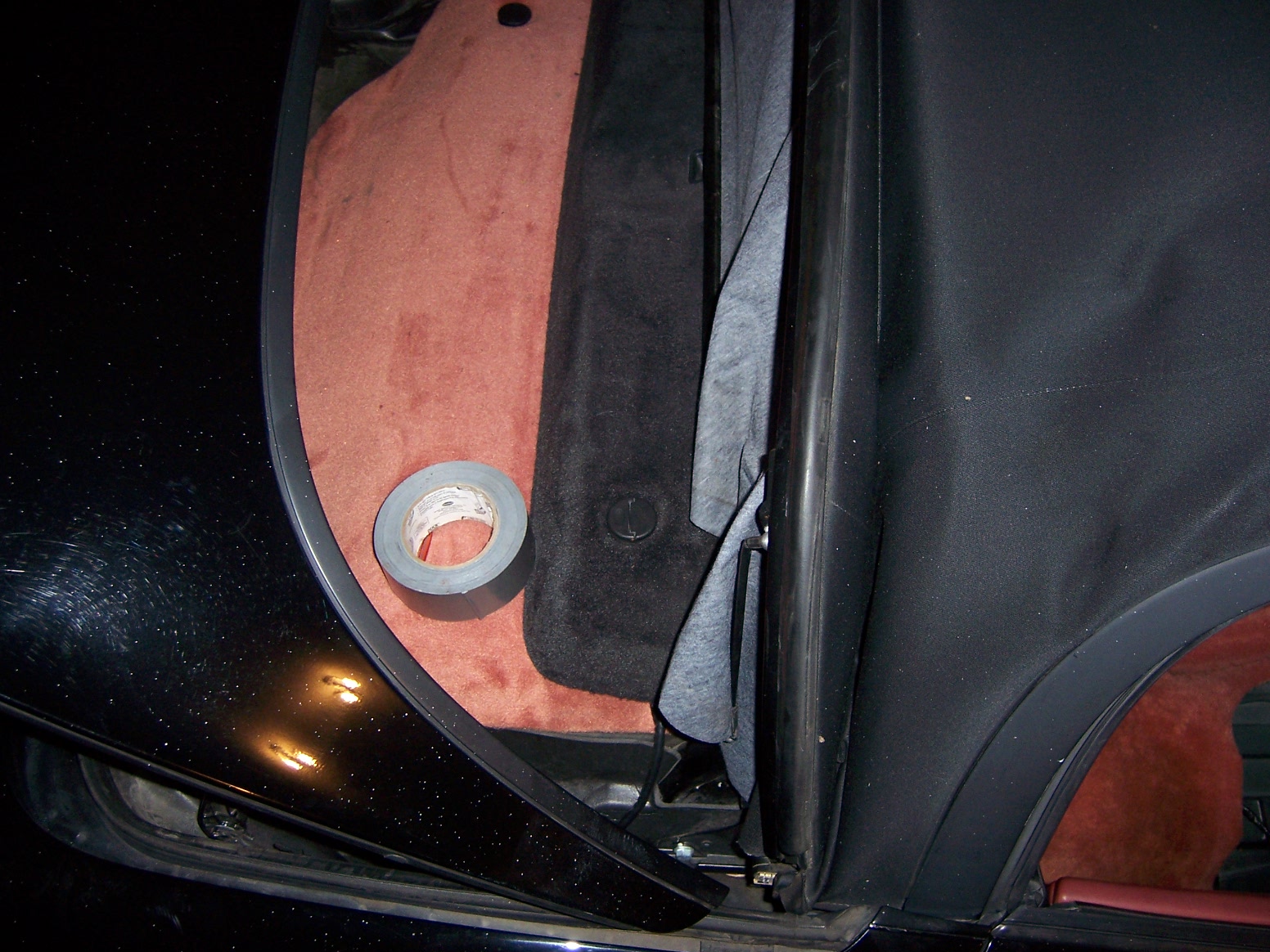

Clamshell service position:
Closer look at foam lining the bottom of the water drainage area:
Closer look at the drain hole, an extension of the foam into a drain.
Mine is ripped a bit on the edges, will patch with duct tape and/or silicone.

Pictures to help anyone else through this in the future.

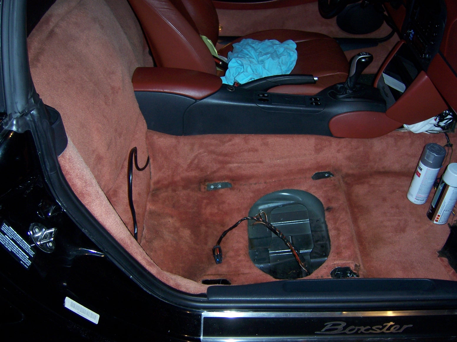

Passenger seat removed:
Carpet pulled back, area was sopping wet.
Thick foam padding/carpet soaked, Plan to Dry:

What is see is mixed up pictures.
The white connector is for an aftermarket rear speaker kit. The black plastic covered wires behind the passenger seat over to the center console are for the rear speakers.
The 2 wire connector under the passenger seat is for the child seat air bag deactivation.

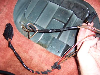

Wiring, possibly for heat elements?
Here is a closeup of a 2 prong plug, factory markings on it, 2 thin wires leading somewhere into the bunch, brown, and white stripe.
Here is a larger view.
Unused 2 prong plug seen up to the right, with 2 thin wires, lead into taped bunch.
Some wires come out from under the carpet, one thick red is prominent, probably + for all, including seat motor.
Some wires probably for seatbelt warning.
2 Thick brown wires that are attached to ground (left side) going into the taped bunch.
but only one coming out of the bunch...hmm...
Electrical tape is not factory, may have to open er up see what's goin on in there.
I can provide more detailed color codes/pics if needed.
Thanks for any guidance!
Good evening TP!
Thanks for the notes, yup, have after market speakers in rear and black wire is that too.
Pictures shown to help anyone else with drain hole location/problem.
2 Wire connector under the passenger seat is for child seat air bag deactivation?
Wow, would not have thought of that!
So does that nix the heat element hope?
Any clarification on the seat heat element possibilities appreciated.

Update:
1- Water problem was indeed clogged drain, 100% fine now.
2- What worked for me:
Pulled up parts of carpet I could and wedged things underneath to hold it up/allow air flow
Small blow dryer, handle tucked in the magazine holder behind passenger seat, pointed downwards
Set on low, moved it around a gew times, left overnight.
2 overnights and the carpet was bone dry in all areas
3- Tool Pants - I have reconnected the seat, and low and behold, the AIRBAG light is now on!
I wonder if indeed, the taped up part has to do with this.
I'll look up posts on how to reset air bag light.
