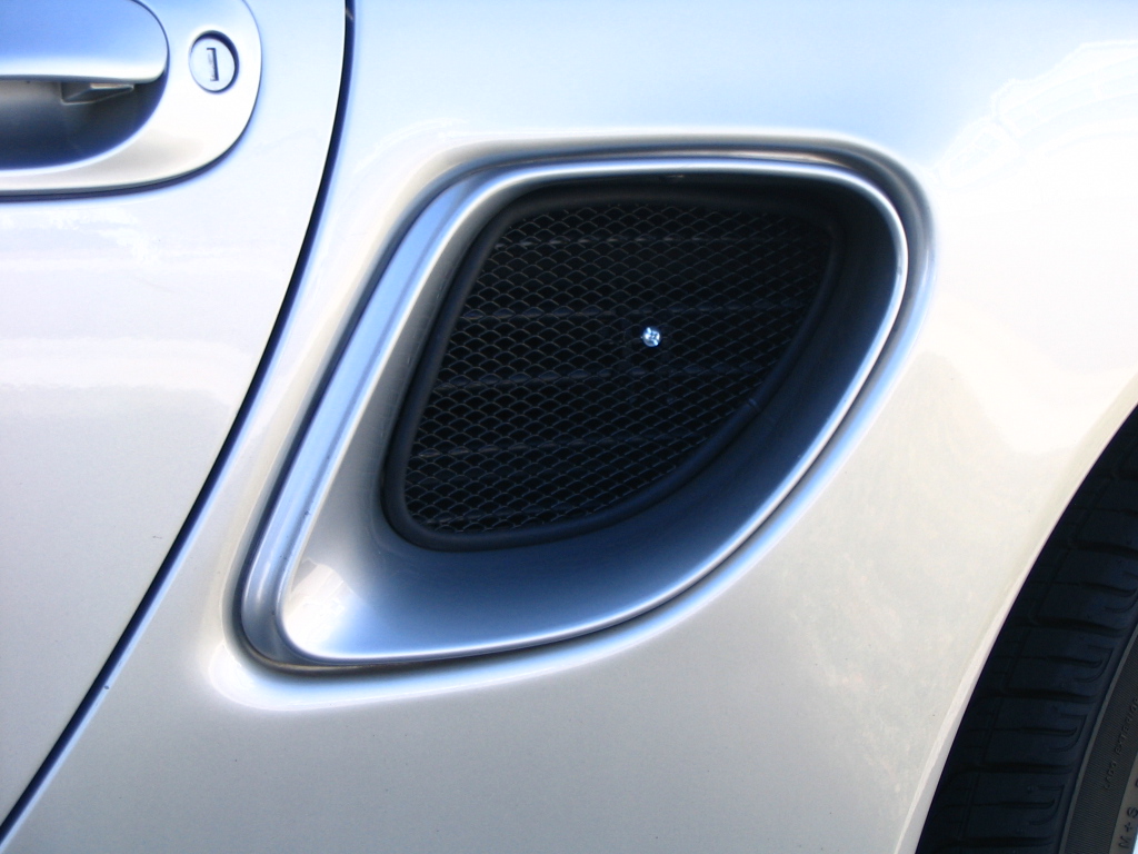

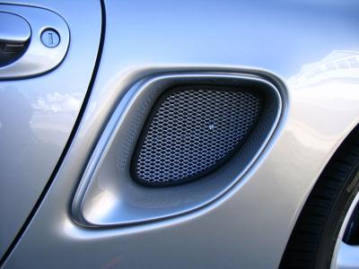

I have your solution to the cigarette butt...(see picture)...I have cut and installed wire mesh to cover the side vents...it has a neoprene rubber trim to protect the car. I made them in silver and black when I was selling them on eBay for fun. It was a race to the bottom with some people who bought mine and then copied and sold for cheaper...so I simply stopped selling...however I have a few stock pieces left over if you want to pay for shipping!
Edited by hooster

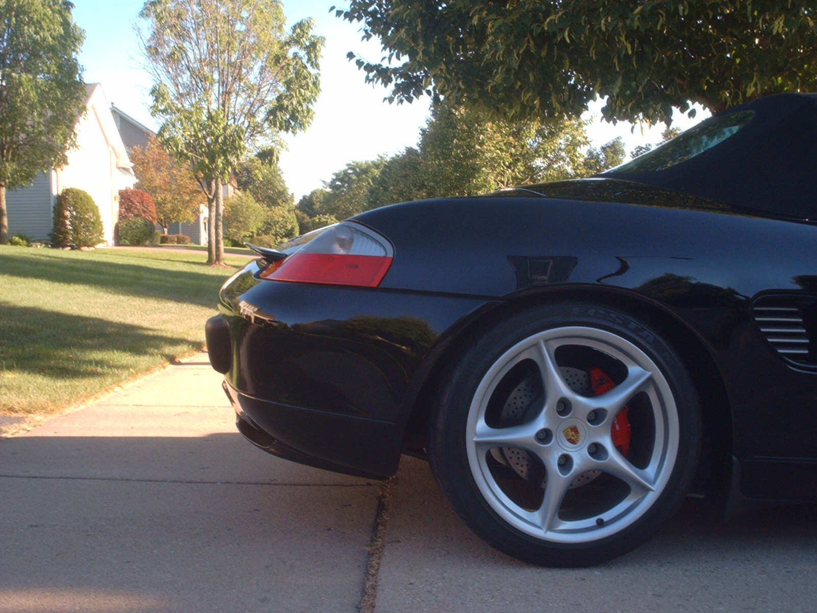

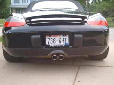

I have this modified factory muffler on my '02 S...very simple to do and the sound is excellent. Low rumble/burble at idle, rips pretty good under hard acceleration. I also have the EVO Hi Flow intake which provides an incredible induction sound...no CEL with either of these mods.

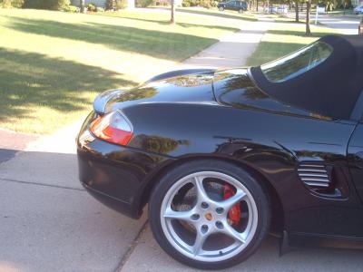

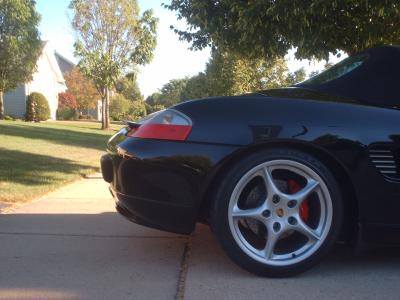

This has nothing to do with the exhaust discussion...how do you like your modified retractable spoiler? I've debated in my head whether or not I should change for the "pass-through" look instead of the "block" look. Do you feel that the spoiler looks too small without the solid bracket? Has there been any change in the feel of the car at high speed? Thanks for any input.
Share this post
Not to highjack gristy's thread, but I personally like the new spoiler. I feel it gives the car an updated look (read Cayman) and is admired by fellow P-car owners, as well. Very simple to swap back and forth, if needed. As I don't track this car (my 911 serves that duty), I cannot comment on high speed stability, as I only drive highway speeds with absolutely no ill effect. "Does the spoiler look too small?" Not at all; in fact it emphasizes the fact there is a spoiler, as opposed to the lip of the standard spoiler.
Share this post

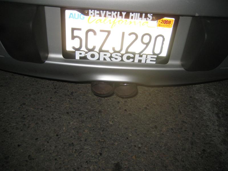

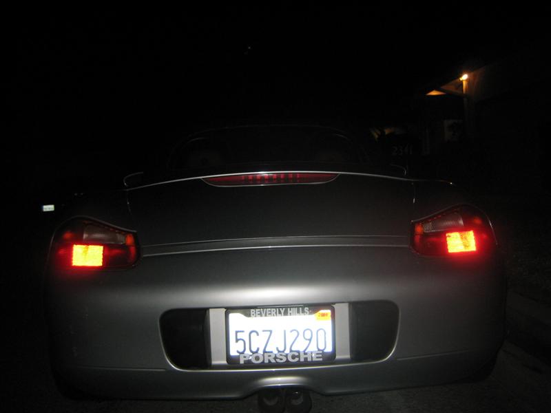

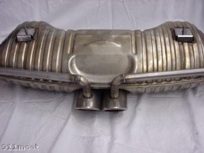

I just put on the Stebro racing exhaust yesterday and I love it!!!!!!! I bought it used off of another member that thought it was way too loud for daily driving....and it kind of is.
Pros: The tips look pretty good, since it uses the dual "boxster S" looking design.
It weighs A LOT less than the stock. I think its around 7lbs vs 25lbs+
It sounds exactly like a Ferrari tearing down the street but only after 4,000rpm (I live near Beverly Hills so I hear Ferrari's tear down the street daily and know what it sounds like)
Cons: It is extremely loud from 2,000-3,000rpm and can get extremely annoying.
You'll end up cruising the freeway and streets at 4k rpm because of the sound point, which will cut into your gas mileage and put additional wear on your car.
Even though it was direct bolt on, my muffler guy had to weld additional brackets to make it fit perfectly (total install was $100)

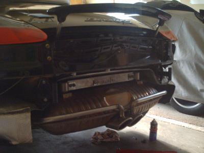

Well the Stebro arrived today after a bit of faffing around, not on Stebro's part - they were very helpful. The shipping company had some "issues" yesterday (when they were supposed to deliver it) so i asked them to deliver to my office. Nothing. Got home tonight and there it was!!!!
First impressions? It looks really well made and much lighter/smaller than stock - quite similar to the Borla exhaust i think. I am going to attempt to swap it out myself either this weekend or the next, once i can persuade someone to give me a hand! If not its off to a garage! Ill try and take some pictures tomorrow to post.
