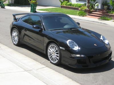

I just experienced this first hand. went with fatter tires in the rear and experienced noticable understeer. I have a 2005 997 carrera 2. I upgraded my 18" 997 carrera III wheels (235/40/18 front and 265/35/18 rear) to new 19" Sport Design wheels with 235/35/19 front and 305/30/19 rear. the 305 rears is what Porsche puts on the 997 GT3 so I figured it would be okay instead of the 295/35/19 on the Carrera S (although they go with 19x12 wheels - does wheel width make a difference as long as offset is okay?). I went with Bridgstone Poetnza E050 tires in the rear which are porsche approved and because the tire center was out of matching Bridgstons for the front I went with Toyto Proxy T1's in the front.
now I am experiencing massive understeer. The Carrera S 19" come with 295/30/19 instead on a 19x11 wheel, is this my problem? Since my new rears are 19x11 do they need to be 295 instead of 305's in the rear.

Here are some before and after pictures -

I just experienced this first hand. Can someone provide any input or has anyone else experienced this. I have a 2005 997 carrera 2. I upgraded my 18" 997 carrera III wheels (235/40/18 front and 265/35/18 rear) to new 19" Sport Design wheels with 235/35/19 front and massive 305/30/19 rear. the 305 rears is what Porsche puts on the 997 GT3 so I figured it would be okay (although they go with 19x12 wheels - does wheel width make a difference as long as offset is okay?). I went with Bridgstone Poetnza E050 tires in the rear which are porsche approved and because the tire center was out of matching Bridgstons for the front I went with Toyto Proxy T1's in the front.
now I am experiencing massive understeer. The Carrera S 19" come with 295/30/19 instead on a 19x11 wheel, is this my problem. Since my new rears are 19x11 do they need to be 295 instead of 305's in the rear.
