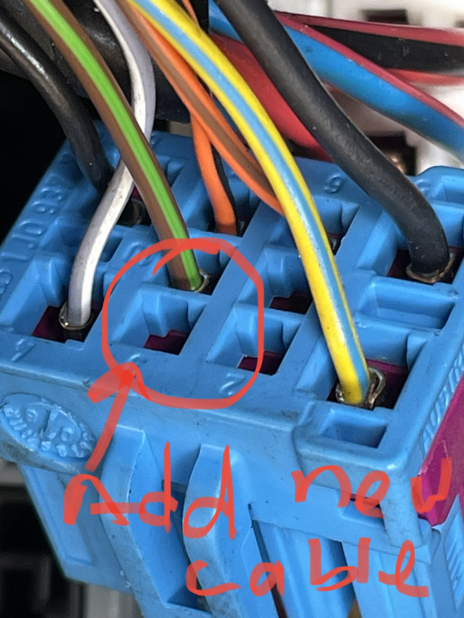

Can I just confirm that the cable does indeed go to the relay carrier (photo attached to make sure) Blue connector Pin 3 (circled Ref) and then direct to the stalk Pin 5?
reason I ask is that some say it goes to the DME Pin A38!
Which one is right??

Hi All,
i went to complete the DME connection on this retro fit on my 2009 GTS (UK model) today. However I noted that it looks like pin a38 doesn’t have a grey / yellow cable in it?? Is it possible the colour changed?
as a fall back I opened the fuse box to connect to the blue connector by adding my new cable to pin 3 which is currently empty. However, when I looked at the receiving side of the connector there is nothing for the new cable to connect on to??
has anyone else noted this or is my car missing the pin required in the blue connector?
thanks!

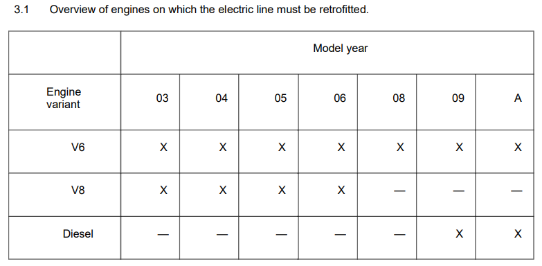

So I have managed to find the answer to my question for anyone following this...
It turns out that my cayenne is a later model GTS (late 2008 build so i guess 2009 model year).  As such these cars DO NOT NEED TO RUN THE ADDITIONAL CABLE AND WIRING (from steering column to DME)!!!  That's right, you just need to fit the cruise control stalk to the steering column, code the car with PIWIS and bingo it works like magic!
From the image below, it looks like the X marks which models require the additional wiring, the - indicates the additional cabling is not required.

Hello Martyn,
I have a 2008 GTS and I noticed as you did too that I don't have the grey and yellow wire at pin A38, so your message with the chart is quite good news. I believe we have different DME modules as the pinout and connector plugs look different than what I've seen in other forum posts, in particular the 957 DME pinout post on this site. Can I ask what the source is of this chart, is it an official Porsche document? Just want to assure myself before I put the steering wheel and lower dash panels back on as I don't want to take them off again!
