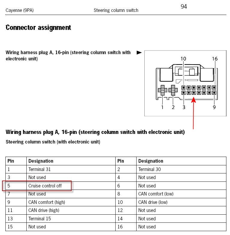

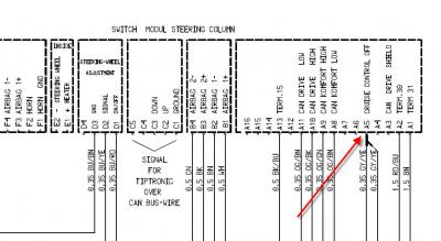

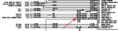

I can't help with photos, but these diagrams show where the wire is connected at the steering column, and where it runs to on the DME (via a plug/socket).

Thanks Richard,
I will have another look this weekend, guessing the plug at the steering side is the one that plugs into the rear left of the stalk module.

It looks to me from the wiring diagram that it might be a 16-pin plug (A), and you may find pin 5 is the place to connect. Are there several plugs which connect to the steering column module?
