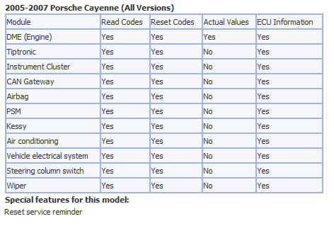

Any recommend place (internet site) where to purchase a Durametric for a 06 cayenne, I do not require a professional version.
My understanding is with the standard its up to 3 Vehicles (VINs) and no round interface which I do not need becuase it will be for my cayenne, correct?
Hey Loren, they dont seem to have it for about $247, as you stated earlier in this post. I should have been more clearer with my question. So was wonder if anyone knew any other site that sells them.
That post was from February 2007 - most companies have raised prices in the last two plus years.
It is now $287. This tool will save you hundreds in the long run.
I have to apologize again Loren I didnt see/pay attention to the post date, and could not agree more. The reason i ask was it kept coming up as $347. I went around a different avenue on theyre site and found the standard version finally, that is $287. I perfer to purchase from them...
Thanks again!
Last question, will this clear airbag lights on a cayenne, has anyone try'ed?

"The Service Reminder can be reset with the Durametric Software (about $247) or by any shop (or owner) with a PST2 or PIWIS.
The original method only seemed to work on a few of the early cars."
