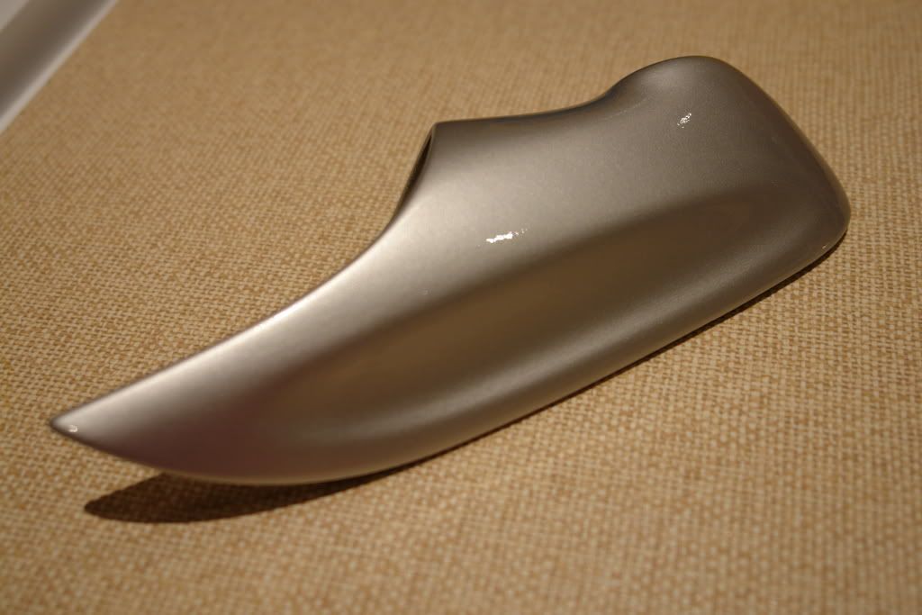

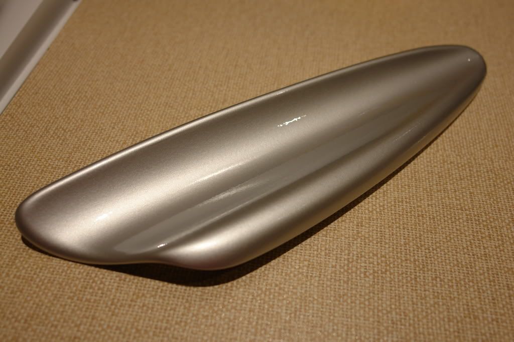

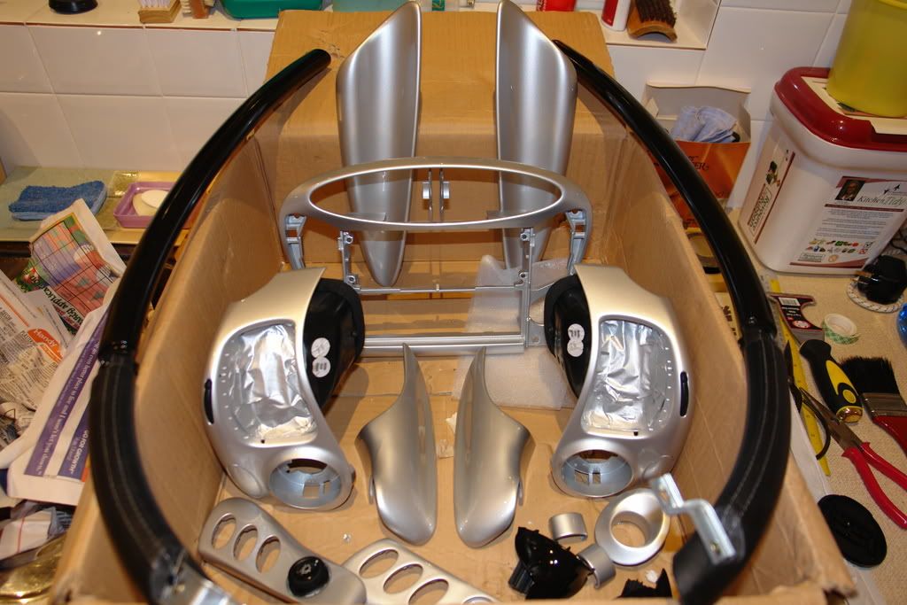

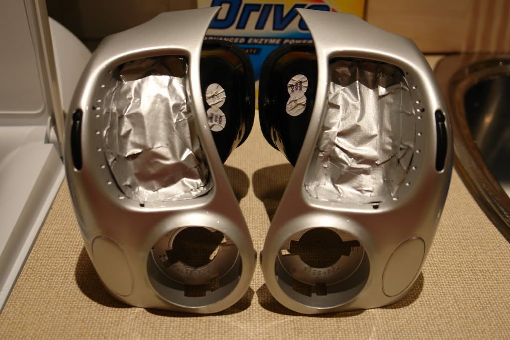

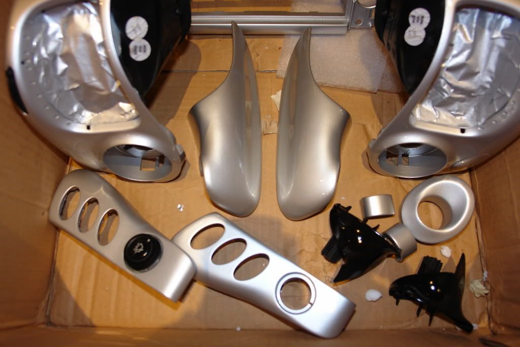

This is it guys, finally got all the pieces back from my painter. Here is some pictures :D
Panameras:
The pieces look really good. Thanks for sharing photos.
Could you be sure to post photos of the car when everything has been installed?
Before and After would be even better.
I know how much work it was for you to take everything out in one piece. I also know you will probably enjoy the reassembly process a lot more!
Good Luck!
They look good!
Is that a scratch I see on your door pocket lid?

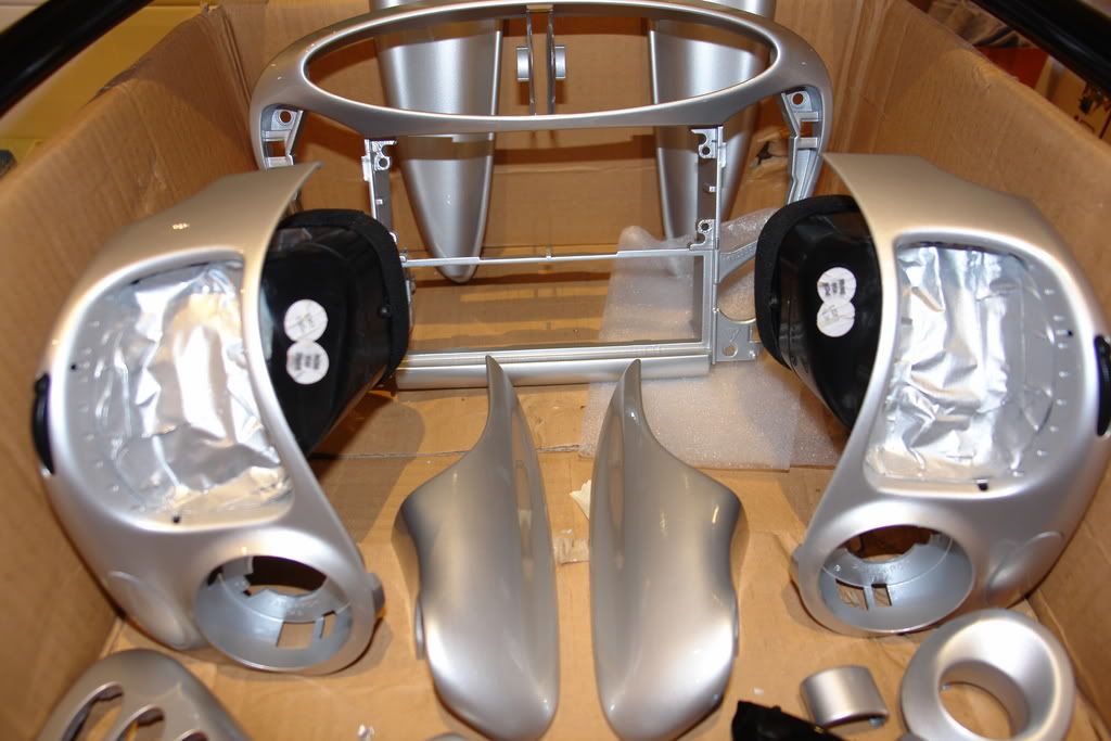

Panameras:
Good Luck!

Thanks juniinc. No thats not a scratch no way I would have allowed it ;) just a reflection from camera flash.

Unfortunately I couldn't get the factory paint code of the interior silver in time for spraying so my painter tried his best matching it. Its not 100% but close enough. Wait for my after photos.
seafeye: all cost me about 450 usd
