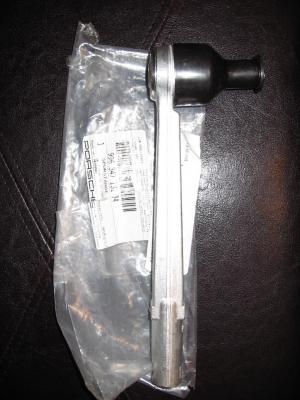

The mechanic in a local aligment shop claims that the right front tire on my 99 c2 has play side to side and the steering link need to be replace and the rack has to be remove to change the part. question is that part 2 separate parts do i change the portion that goes to the tire side or the inside part he claims that causes the car to pull to the right . Which part is bad in your guys opinion?.

Find another shop. The rack does not need to come out to replace the outer track rod. I didn't take the protective cap off before snapping the pics so you can't see the threads of the ball joint.

Thank you i will order the part
