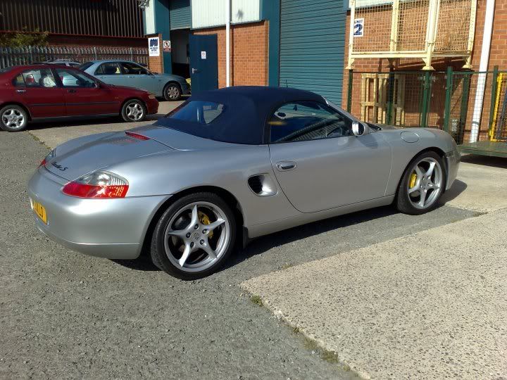

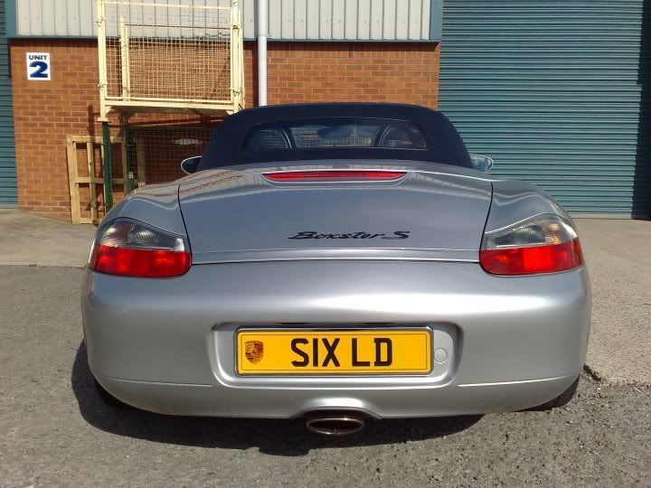

I purchased the hood convertion from BAS in UK - http://www.car-hood.co.uk/
I rate the fitting of this pretty easy for anyone who is a bit of a `have a go` type of person. Dont worry about
the stories you hear of the glass breaking, it works perfect if fitted properly.
Here are some pictures:
