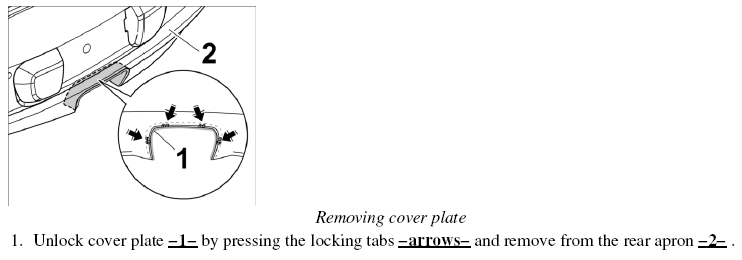

how do i remove the plastic exaust piece trim
sapple89
  • 5 months later...
Please DO NOT double post.
thanks got it off

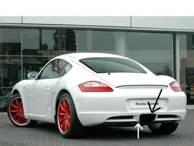

Same on the 2008 Boxster S?
Yes, it is the same piece.
Sapple89 - so how did it turn out? I took mine off and painted it with a semi-gloss Black, Hi-Temp paint. I think it looks great and so far it is holding up fine (6 light coats).
