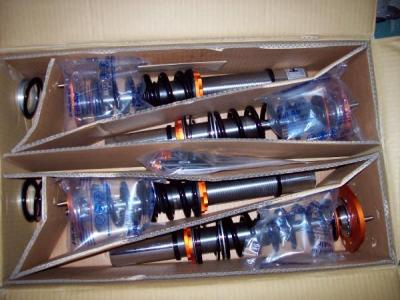

Ok some upgrades i did : :D

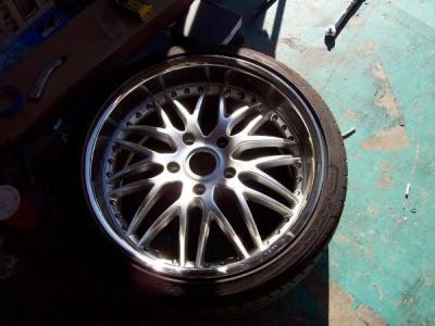

" 19" wheels, 19X8.5 front + 19X10 rear + pirelli Pzero tires"

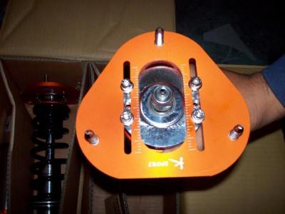

Ksport adjustable Coilovers, Adjustable Camber "The 3 pics above"
Tools to adjust coilover "from left to right.. (6brake line holder + 4 rubber gourmet) + ( 4 ride comfort adjustment pins "with orange head" ) + (ride hight adjustment tool "2 black pieces in the bottom" ) "

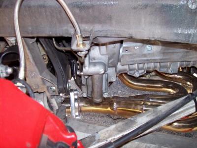

Coil over installed "notice the braided brake line"
Cross drilled brake rotor and painted caliber red + white porsche sticker
better pic of braided brake line "you can also see the Fabspeed 3.2 headers"

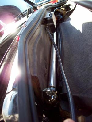

Rear Brace
Front brace

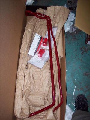

Eibach Anti-roll bar kit "front and rear" "notice my foot on bottom right hand side ha ha ha"

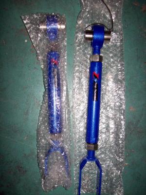

Adjustable rear toe arms

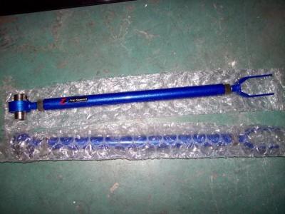

Adjustable rear track arms

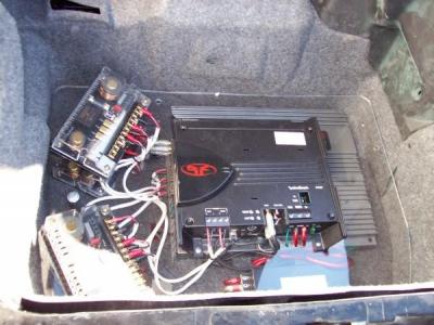

I used wooden base covered with matching carpet to mount amp1 + capacitor + 2sets of cross overs
then i added a 2nd floor out of plexi glass to mount amp2 and 2nd set of cross overs, eh first time
doing this but i think it looks good.. i hope lol.. oh yeah and i got rid of the spare tire to make space :(
here is whats inside:
Amp 1 : “A/D/S PQ40.2” 4 x 100Amp true RMS to run front and rear speakers “high
and mids”.
Speakers and cross overs: 2 X MB quart Qsd-213 for front and rear speakers .
Amp 2 : Rockford Fosgate to run subwoofer
Subwoofer : Focal 13ks , 5” 180 Watts “Bass”
Capacitor : Alumapro Cap5 , 5 Farad.
Head unit : Nakamichi CD-400
and mids”.

I heard the K-Sport coilovers are HARSH. How do you like them?
Well I did not address the whole suspension issue yet. I took my car to an alignment shop for standard alignment, so far so good. But I do want to lower the car in the rear a little, plus see how far can I go with perfecting handling. I had Eibach springs with standard boxster suspension prior to this; the car drove more comfortably with the Eibach springs. Yes now it seems harsh in comparison to before. Where did you hear or read it rides harsh with k-sports? Any info would be helpful with my current updates.

Ali. The K-sport suspension looks almost exactly like my G4 Racing system.
http://www.renntech.org/forums/index.php?showtopic=11342
They could well be different branding of the same stuff. If they are the same, then my experience with mine is they are very harsh indeed. My back hurts a little after driving in the car for too long. All speed humps must be approached very cautiously. I don't race my car. So I don't know how much improvement it offers on a track. But on the road, it certainly reduces body roll and improved cornering a fair bit.
